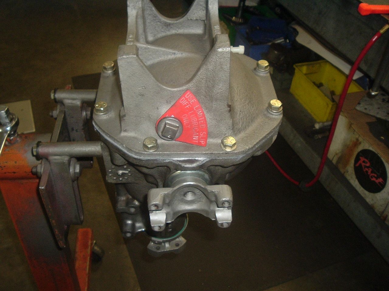

                                Re: Anti-Rust products vs Clear Coat on Natural Finish Parts - Pros/Cons
                                Here's a casting with Valspar clear flat paint.
