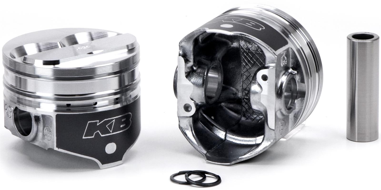

                  I'm in the process of rebuilding a '61 315HP 283. I've chosen the Duntov equivalent CS113R camshaft and AT 992 lifters, both from NAPA made by Sealed Power.
                  I'm also in the process of piston selection, and I'm looking at the Keith Black Hypereutectic domed piston, KD-166. Dome height is 0.170".
                  Specs here.....
                  Free Shipping - KB Performance Pistons with qualifying orders of $109. Shop Pistons at Summit Racing.
