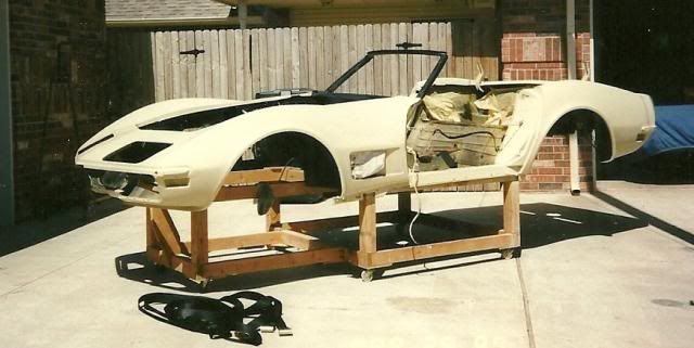

    Here are some pictures of the body dollie I used on the 63 and my 65 . It can also be used on C3s with slight modification .DSCN1355.jpgDSCN1357.jpg

      Nice build Bill. Mine was built as well to accomodate C2/3's and allow good access to underneath side of body for repair or restoration. It's also built to separte where I can store the front smaller portion inside the larger taking up less storage space.
