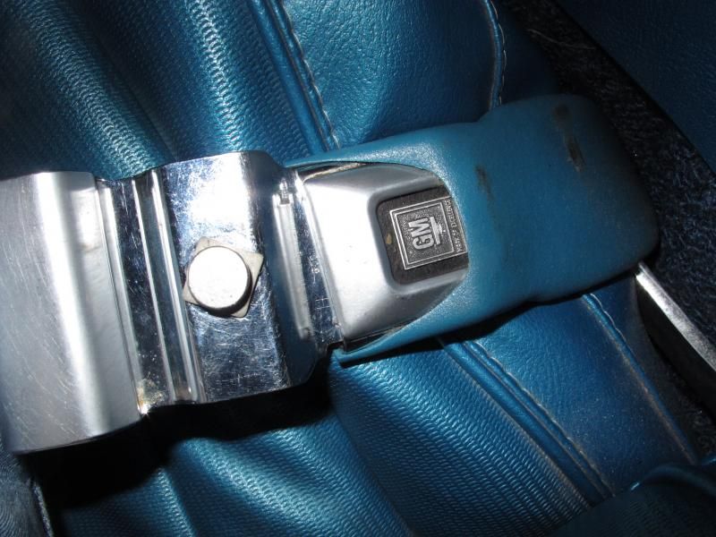

      • Mike F.
        • April 25, 2011
        • 668
        Re: 1970 seat belts
        My original 70 lap belts (outboard/male end) are approx. 36" in length. Do you have the correct female end (inboard/encased in plastic)?

          • Bill L.
            • February 1, 2004
            • 1403
            Re: 1970 seat belts
            [ATTACH=CONFIG]49678[/ATTACH]
            Hi Mike,
            One of these days maybe we can park our 70s side by side as mine is L46 Classic White too
            FYI- The retractors on the shoulder harnesses do not appear to be correct. Is there some kind of cover over the retractors?
            They should be metal with white plastic caps inboard and outboard.
            That is what I have on my original and dated shoulder harness belts on my 70 Convertible. Belt Date is B 70.
            Bill
            • Mike F.
              • April 25, 2011
              • 668
              Re: 1970 seat belts
              Originally posted by Bill Lennox (41387)
              Hi Mike,
              Bill
              The pic I posted was found on the internet. I posted it to show Wolf an example of inner/outer lap belts. Not sure why his lap belt is 51" long or why a 36" (which seems to be correct) won't attach with the seats forward?

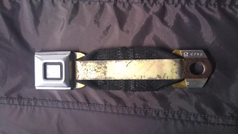

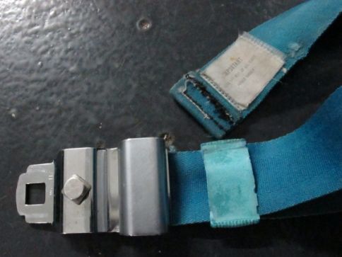

              • Wolf S.
                • July 15, 2009
                • 94
                Re: 1970 seat belts
                hi
                i unearthed some photos of my inboard belt. it's black, not blue as it should be, but with a correct date. once the blue sleeve on,
                one cannot see if it's black or blue.
                they seem shorter than the ones in your pictures. if my seats are in a forward position it's nearly impossible to buckle the outboard lap belt in the inboard one as the female buckle would be positioned at or behind the seatback. this situation would be the same even if the out board lap belt was 36" or 51" long!
                so what would be the correct webbing length for the inboard belt?
                well, it seems that bubba has also been around this part of the vette.
                here are the pictures
                7 3/4"

                • Reba W.
                  • 938
                  Re: 1970 seat belts
                  The inboard belt on my 1972 has 5 1/2 inches webbing and an overall length of 9".
