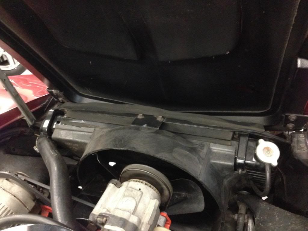

        Well Bill I have to do some more Photobucket stuff. My phone takes larger and better pictures than my camera, but they are too large for this board and I haven't figured out how to re-size them yet. I had intended to PM Mike, but here you go.
        Below:1970 LT1 14544 (I have yet to verify the originality of this foam, but I am pretty confident it is)
        Below: I failed to get the VIN of this late 1970 LS5. It will probably be next week before I can get it.
        The measurements I provided in the earlier post are from this LS5 car.

          There are some nice details in those photos even without looking at the radiators or foam.

              These are photos of my 70 LT1 VIN # 14803 (July 8th build) with the one piece seal. This is an original for sure. Seems like our current JG needs some corrected wording.

                Dave,
                That's a very nice condition original seal. My two '71's have nice original seals like that also, so much nicer than the 3 piece set-up of the earlier built cars.
                  Hmmm-Wonder if they went to one piece on LT1 and LS5 versus 3 piece on base and L46? Very interesting.

                    There was a lot of changes going on, and we have done a poor job of tracking that -- especially given how in-your-face that foam seal is.
