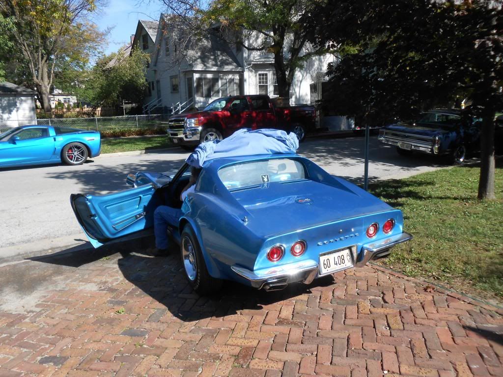

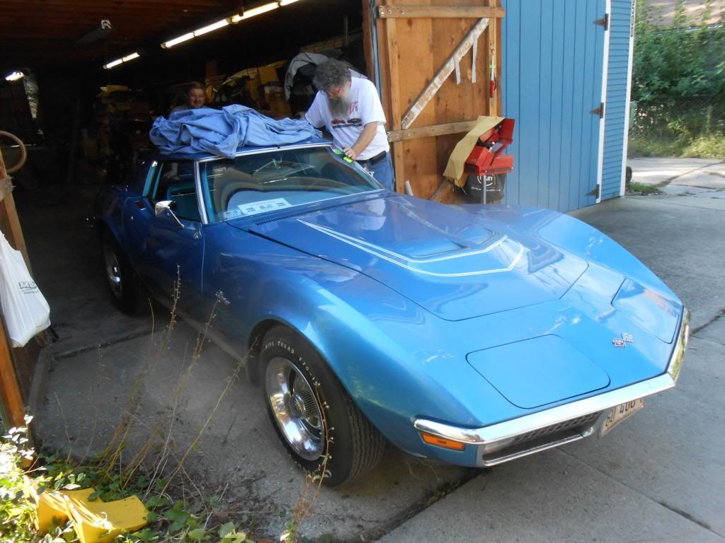

    You mean like this?:
    and
    I don't recall a Playboy ***** being in the JM. Perhaps that's a 1970 only feature. Seriously ...Beautiful car!
    Edit: wow....The forum filtered the word *****.
    Mike

        Absolutely JR. Nothing but the best for my baby. BTW: I didn't intend it to come out that way, but you can see the Jet Stream Blue across the street. Nice comparison to the Mulsanne Blue. Too bad the Deep Water Blue of the Chevelle is hiding in the trees to the right. That's another Krylon Clear job also.

              That photo is October 2013 when the 1970 left the garage for the first time in 9 years. Patrick, if I am in the photo you can tell when it was taken by the amount of gray in my beard.
