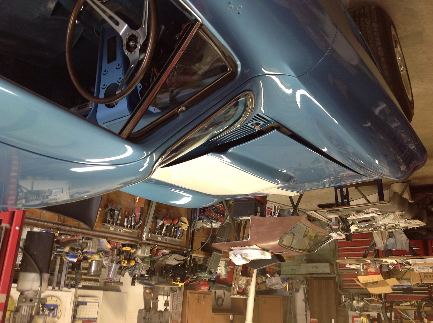

    This 67 was shot with Marina Blue lacquer with no clear coat. It will be driven about 0.10 miles per year. It came out great.
