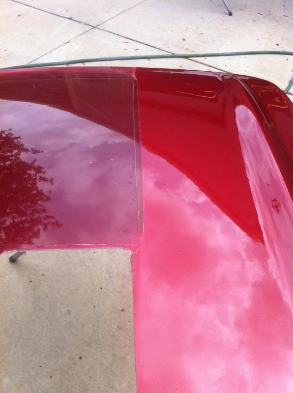

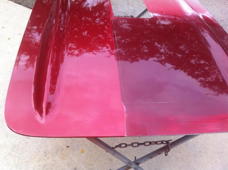

                            Did a test spray.
                            The Marlboro is much "brighter" than the Milano.
                            Photos/lighting make both shades appear much more Pink than in real life.
                            G.

                              George:
                              The Marlboro Maroon color shown is pretty, but it is nowhere close to the original color/shade.
