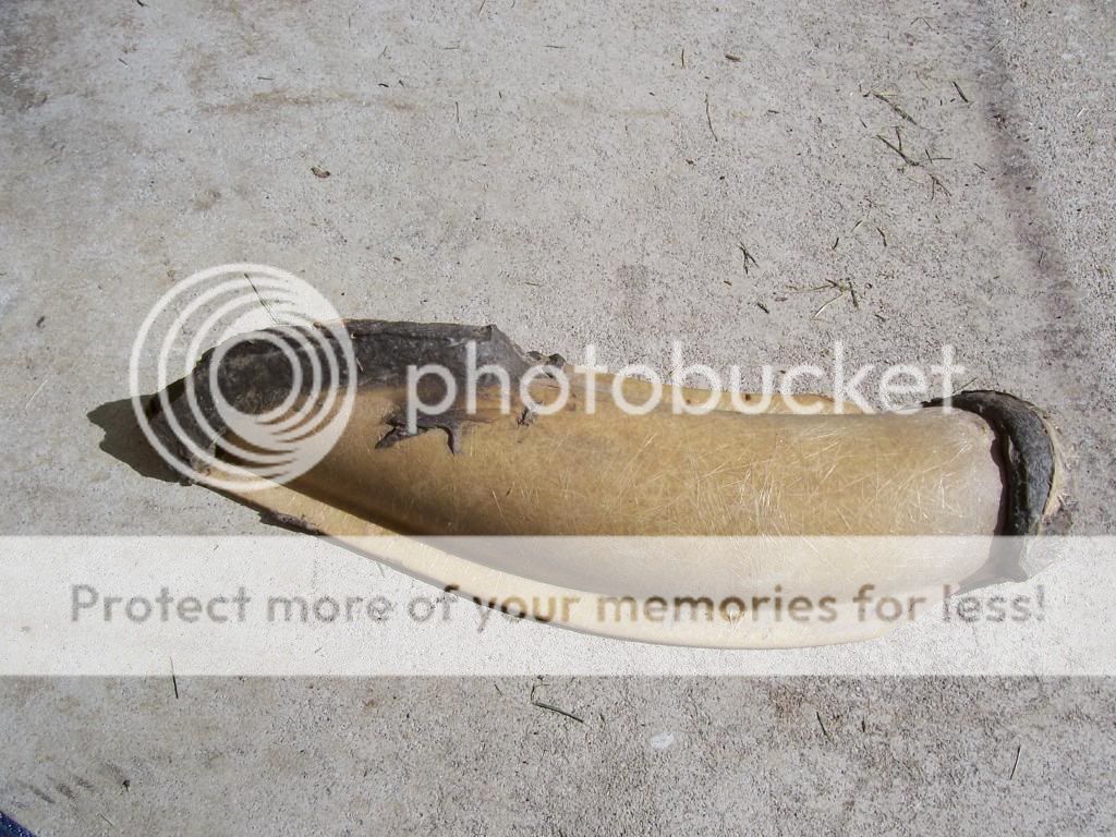

                          Re: 1958 "Exhaust Tube" trunk area question
                          The top half of the fiberglass tube for the driver's side on my Dec. '58 assembled '59 has come loose.

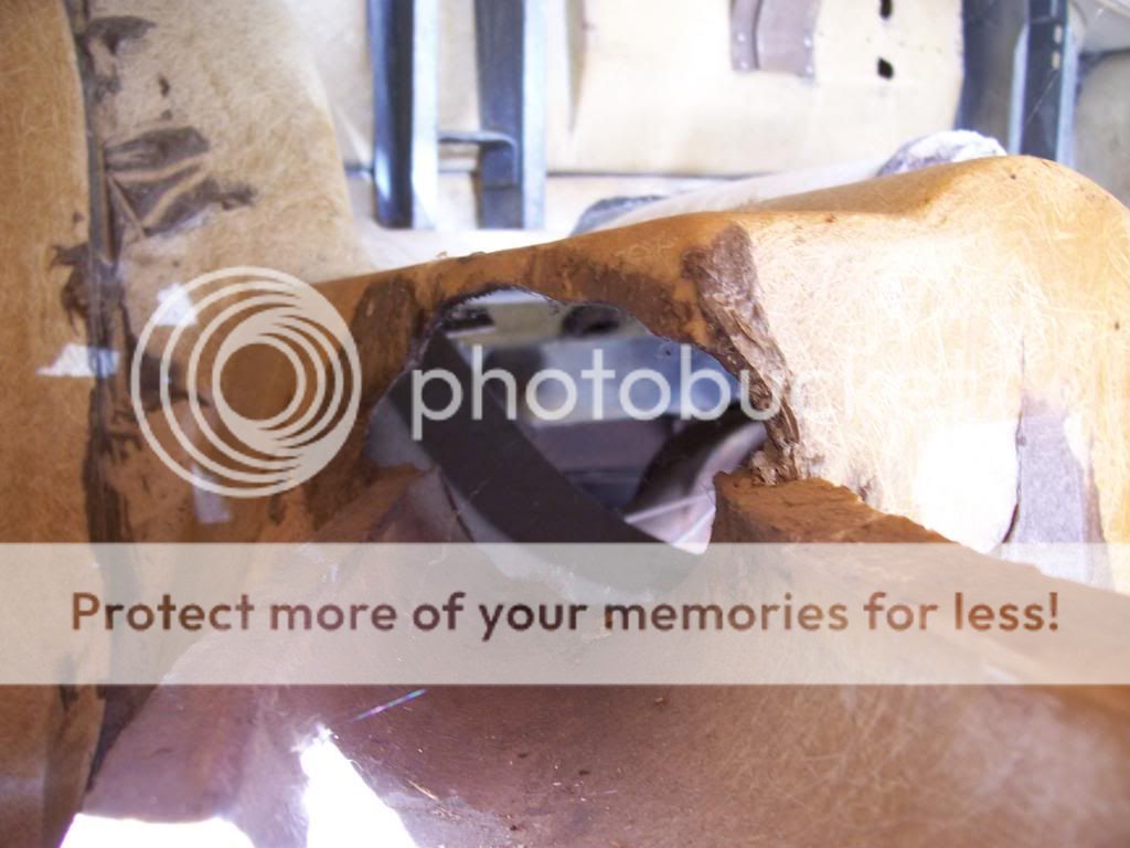

                          Here's where that tube fits into the body:

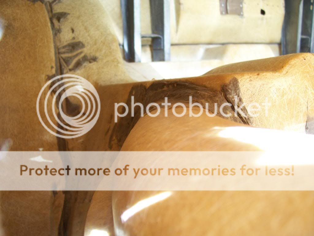

                          And here is how the tube fits when it is installed:
                            Awesome! Thanks Bill. Gives me a good perspective on how it mounts.
                            I think I might get the exhaust fit first, then install the tubes around the tail pipe and resin them in. This way I get the tube alignment correct. The opening on my trunk is pretty big which would allow a lot of "misalignment" if I try to install the tubes first, then try and fit the tailpipes through them.
