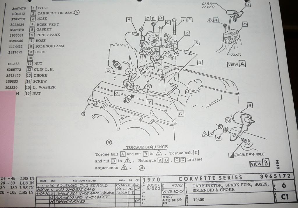

    What is the thickness of the carb/manifold gasket (#3967470) supposed to be for the 70 L-46? Is it in the .030-.050 range or more like .250?

    Mike------
    It's the THIN gasket. And, it doesn't have 4 holes as in the AIM diagram. It has just one large opening.
