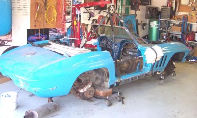

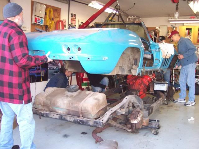

                No need to remove engine/trans....your looking for trouble there. As as been mentioned by others:
                • Ties knots in straps
                • Get boom/picker closer to vehicle
                • Shorten up stroke length
                • Take wheels off car, I used my tire dollies.
                Picks aren't the best but you'll get the gist. You'll notice how I supported rear of car with a turnbuckle/wire/screw in eyelet...hooks on either end.

                  Re: body lift C2
                  Nice pics Michael, thanks for sharing. I like the turnbuckle setup.
