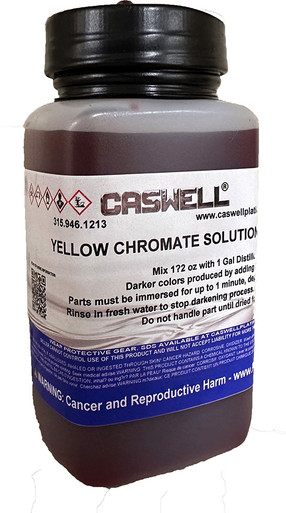

              Here's the stuff I used in the carburetor thread:
              It is not as hazardous as cadmium. But it does ship as hazardous like spray paint.
              I dilute it with distilled water and heat it up in a plastic bucket or crockpot.
              It works on both zinc and cadmium plating
              On potmetal (which is mainly zinc) you don't have to zinc plate before you use it. Just prep the part to a bright shiny finish and dip it for 20-30 seconds in the heated solution.
              See the thread in my post above
