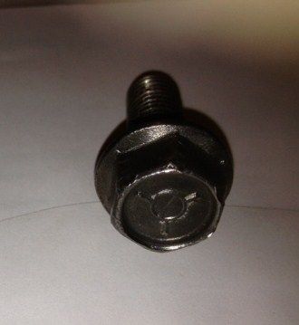

    What is this bolt and where does it go?
    http://
    It is 3/8"-16X1-1/4", completely threaded. O headmark with an I or hash dissecting the O.

    Scott, I had an idea about where that bolt belongs and confirmed it, It belong on the back of the A/C compressor, Its the lower pivot bolt. I checked my 72 its the exact match.

      Thank you! I knew I had seen that bolt somewhere but did not know where. I do have factory AC on my '70.
