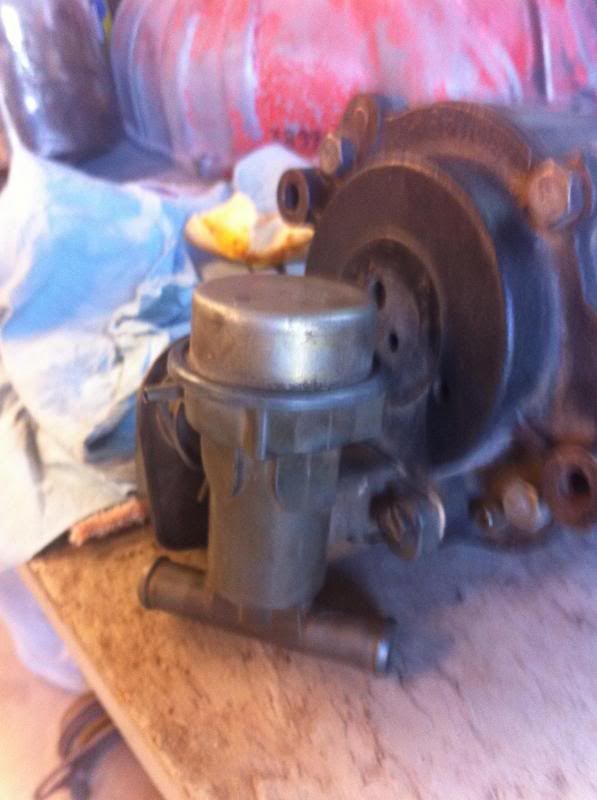

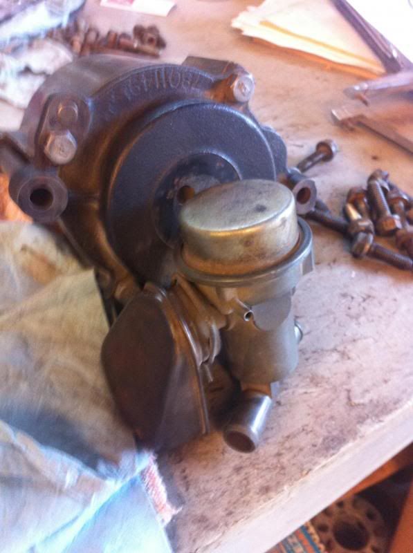

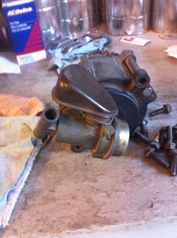

    28296 is accepted as the correct diverter valve on '68 427 AIR systems.
    I have a very late '68 engine that is/was very original and complete--(starting parting out after efforts to find car/owner failed).
    AIR pump is coder 184th day of 1968, first shift, Y plant.
    The diverter is coded 24763.
    Every other part/piece on this AIR system has correct dates/stampings/bolts/clamps/etc.
    Wondering about this 24763, was there a change late in the '68 production year?
    Is it a service replacement piece?
    George

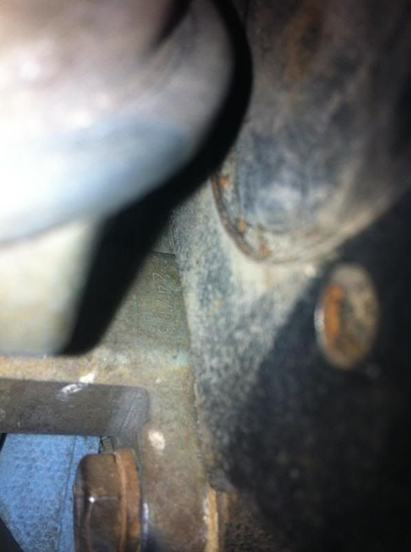

    I can't find any record of a diverter valve with identification number 24763 (which would be a derivative of a full part number of 7024763).
    Are you finding this number STAMPED into the main body of the valve near the flange which connects it to the AIR pump?

        George------
        I can barely make out the stamping on the valve but it does look like it is 24763. As I mentioned, that would represent a valve of GM #7024763 and I can't find any information on such a valve. However, the valve is configured as I would expect for a correct 1968 big block. This configuration is somewhat unusual and I don't know of any other non-Corvette valves that are configured exactly like it. Some 1969+ big block diverter valves are similarly configured but differ internally.
        The 1968 valves were also unique in 2 other ways. Most 1968 valves used a muffler that was not an integral part of the valve but was a separate piece attached with a clip. For 1969+ valves, the muffler was an integral part of the valve and was "crimped" to the valve. 1968 valves also incorporated no relief valve. A separate relief valve was integral with the pump. For 1969+ valves, the relief valve function was incorporated into the diverter valve and the relief valve was deleted from the pump.
        By the way, the 1968 big block valve and pump was also used for 1969 L-88 and ZL-1 but not for any other 1969 or later application.

          Sorry the photo was not better.
          Every other aspect of this A.I.R. system is correct--deep groove pulley, correct stamped hoses, dated clamps, etc.,etc..
          Are you saying that the '69 L-88 and ZL-1 used this set up, but with the 29296 valve?
          Seems very odd that there is no information on this 24763 valve.
          Oh well, thanks the input.
          George
