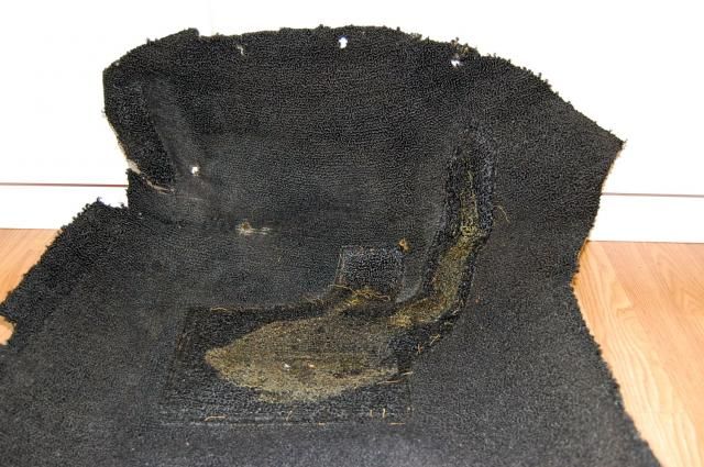

      On my 71 (6589) it appears the upper edge of the carpet was laid on top of the insulation and it's plastic "cover" located below the steering column.
      I'm thinking that if it had been tucked under the plastic cover the cover would have left an impression in the carpet nap.
      I'm not sure just how typical this might be.
      This is the original carpet.
      I moved the heel and dimmer pads to new carpet.

        This is what I typically find on original cars.

          Really? I'm glad this subject came up. I assumed (but don't know) that the firewall insulation went on top of the edge of the carpet for a more finished look. So if I was wrong, then I installed my carpet incorrectly.
          Is the front edge of the carpet on top of the insulation on both the driver's and passenger's side?
          Mark Edmondson
          Dallas, Texas
          Texas Chapter
            • 3422
            Re: C-3 Carpet Installation - Carpet Under or Over Firewall Insulation on Driver's Si
            Hi Mark,
            Yes, it's typically the same way on the passenger's side.
              • 11698
              Both of those are consistent with what I've seen as well, including the car I was working on yesterday.
