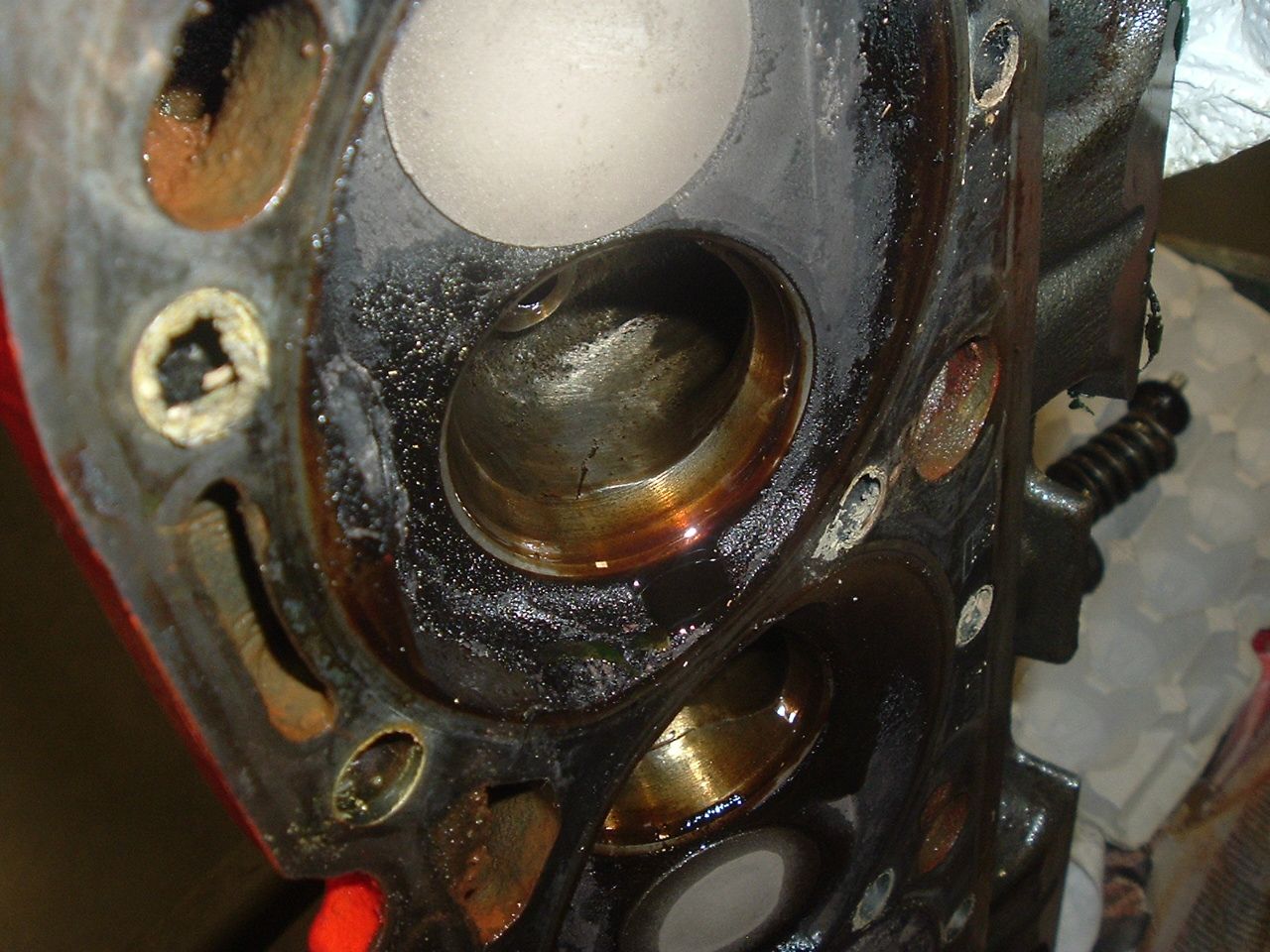

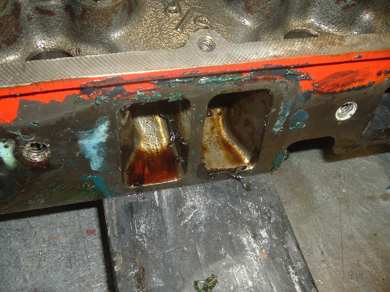

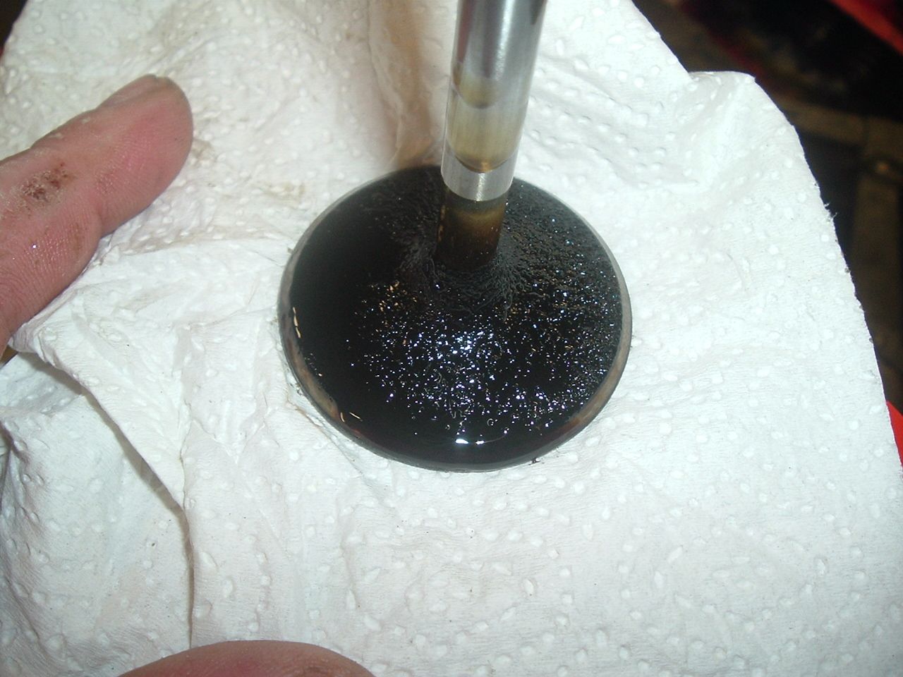

      Here are the pic's from last month when I pulled off the SR Torquer heads. I just placed the head on the bench and came back a little while later to find the oil running out, then pulled the valve.

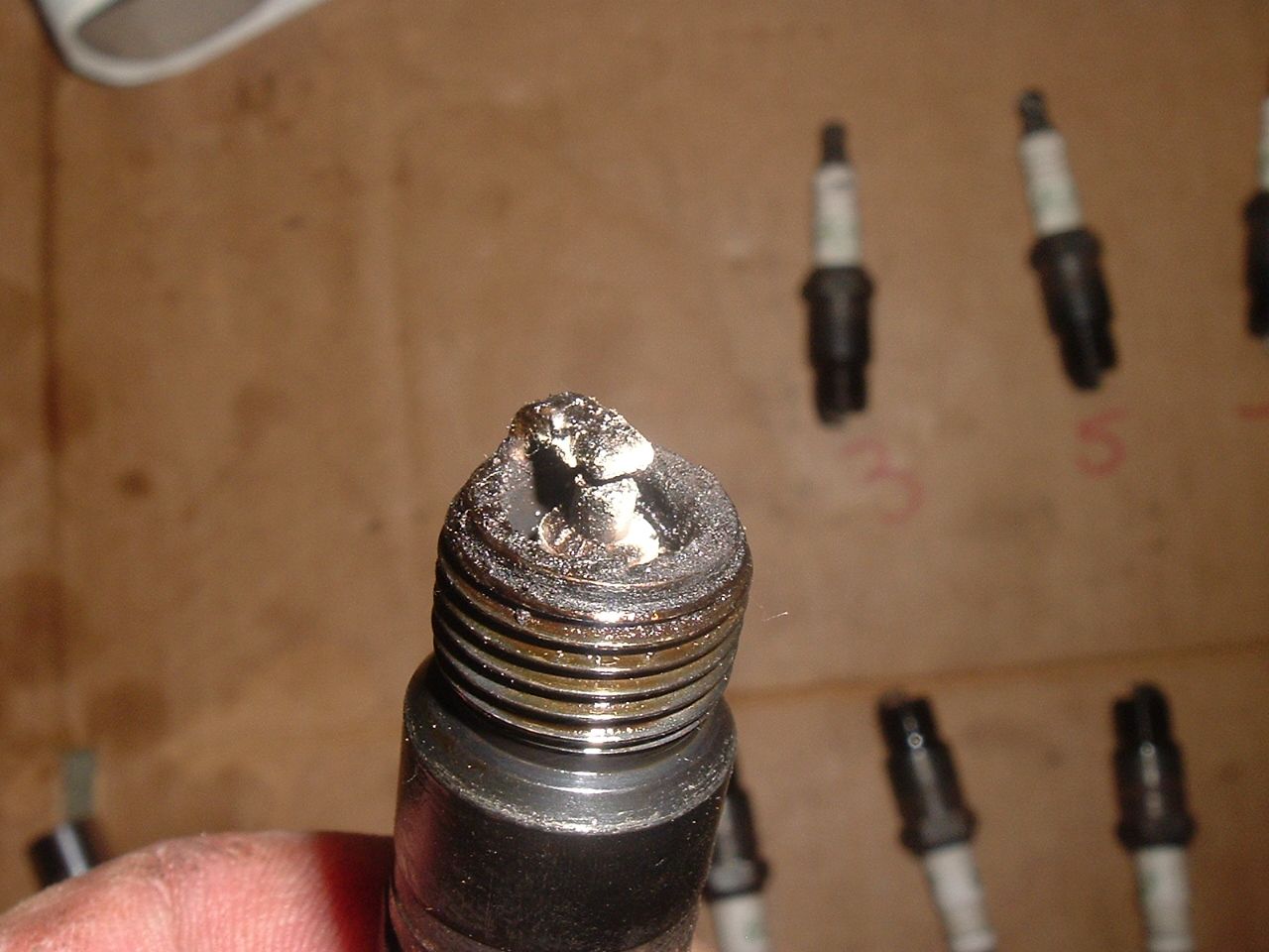

      Here is #1 plug, good example of the dividing line on the plug. Intake fouled, exhaust white.

          It's NOT a good idea to use RTV around intake ports, including water ports because RTV is attacked by gasoline, and will encourage gasket creep.
          If you continue to have problems, I recommend that you use a steel core laminate gasket, such as Fel Pro 1278S or 1205S3

              Did you also find oil in the intake manifold plenum and runners?

                I have used a quality RTV sealant around intake gaskets since it became readily available in the automotive trade and had no problems what so ever.

                  RTV works if the mating surfaces are perfectly flat and the ports line up well. Aftermarket heads/manifolds may cause some misalignment or if OE deck height or head locating points are different, fuel can and will penetrate and once intrusion begins, leaks/gasket failure and creep will follow in short order.

                    Joe & Joe, I did not find any oil in the intake runners. The blue material you see around the intake runners is not RTV but rather Permatex Hylomar. I used it the 2nd time around to hold the gasket in place because I was concerned it would have moved. The Hylomar is fuel resistent and pretty much like contact cement, this time around I used Gasgacinch which is also contact cement. I have used RTV around the water ports and on the china walls for the past 30 years.

                      I was just starting past experiences with engines that I know, within reason, did not have perfect alignment. One of the applications was medium duty truck engines that almost invariably had cylinder heads milled at least one, if not multiple times during their useful life. The intakes were never angle milled. The trucks were loaded to max GVW and we'll over at times. The trips were from twenty to one hundred miles. At night the entire exhaust system, to the end of the tip would glow cherry red, an application that would greatly exceed the requirements of any street engine and of the majority of common race engines. There were NEVER any problems with RTV sealers.
