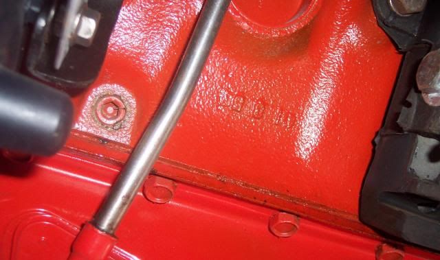

        Passenger side, right in front of starter. Drivers side same location, however will be masked by exhaust manifold (if stock). I used recessed allenhead plugs however yours could be hex or square headed plug. Both plugs would need pulled to empty the block.

          great picture, I have seen that plug but did not know what it was for. thanks, Dutch

            How would be the best way to remove. Looks like they would be a pain in the rear to remove if they have been in there all thei life. Looks like they would strip out too.

              Does anyone have any experience with the removal of this allenhead plug? Dutch

                    The passenger side has the allenhead plug in the middle and a 4 sided plug at the far end. The drivers side has 3 allenhead plugs with a 6 sided plug in the middle above the allenhead plug. Is this norm?[ATTACH=CONFIG]47458[/ATTACH][ATTACH=CONFIG]47459[/ATTACH][ATTACH=CONFIG]47457[/ATTACH]

                        The square-head plug directly below the fuel pump doesn't get touched - that's where you remove/install the fuel pump pushrod on a big-block. The two you want for draining the coolant are one on each side, just above the pan rail.

                          I am still researching this event and waiting for my waterpump from Bill. John, on the left side of my block there are 3 allenheaded plugs, 1 on either end of the block and 1 in the middle, right below a 6 headed bolt as in the 3rd pic. Is that the drain bolt or do I use the allenhead plugs to drain? On the right side I only have the allenhead plug. thanks Dutch

                              Harry, the small allen head plugs on the drivers side of the L36 are oil galley plugs, the larger hex head plugs one on each side go into the water jackets.
