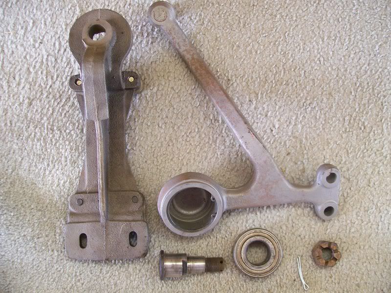

            Here is a comparrison between 53-54 pass car (left) and 49-52 pass car/53-62 Vette (right) spindle supports.
            "Back in the day", some racers used to swap 53-54 pass car supports onto their early Vettes to drop the frontend slightly. Doing this, along with the 57-59 HD springs will noticeably drop the frontend (which of course lowers CG). This is definitely good for road racing handling, but not so great for regular street driving. I certainly don't want my 56 dropped any lower than the stock height.

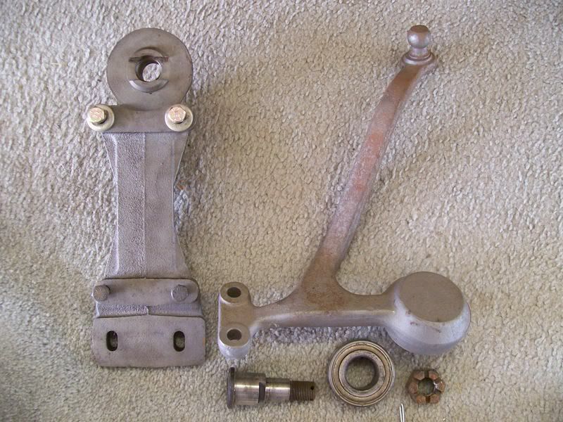

                The center steering arm on pass cars is hinged with a kingpin/bushing type setup. The Vettes used a HD ball bearing and both the mounting brackets and center steering arms are totally different. I don't have a picture of the pass car center arm/bracket, but below is the Vette setup.
