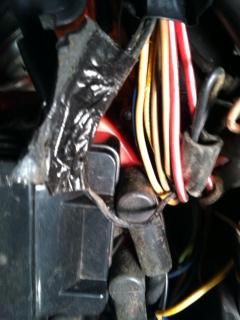

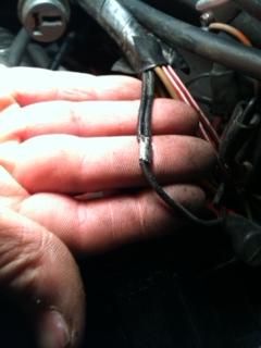

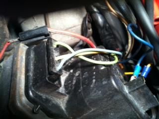

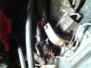

                  blue72/photo5_zpse7affaa6.jpg[/IMG][IMG]http://i156.photobucket.com/albums/t32/z10kl/targa blue72/photo4_zps8e7e42b3.jpg[/IMG]
                  • Keith L.
                    • April 7, 2008
                    • 378

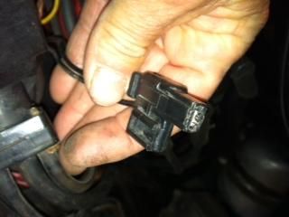

                    Re: 72 wiper door
                    What is this plug for. It wasn't hooked up. I opened up the harness and the only thing tied together are these two black wires. They are hot with the switch on.
                    • Keith L.
                      • April 7, 2008
                      • 378
                      Re: 72 wiper door
                      All these wires are hot as soon as the switch is on except the green one. If I unplug the three wire plug the red wire looses power also. But if I unplug the red wires the blue and yellow in the three wire plug stay hot.

                        • Monte M.
                          • January 1, 1991
                          • 687
                          Re: 72 wiper door
                          Keith,
                          After looking at your pictures, it looks like your wiper motor is very different than mine. The black plug you asked about is the main ground. It plugs in just about where your three wire plug is now while the three wire plug should be just to the left of where the wires go into the top of the motor.
                          When was your car built? I have learned that just because something does not look like what I have, first, maybe mine is wrong. Second, it might be a production change. My guess is in this instance is, it is the wrong wiper motor.
