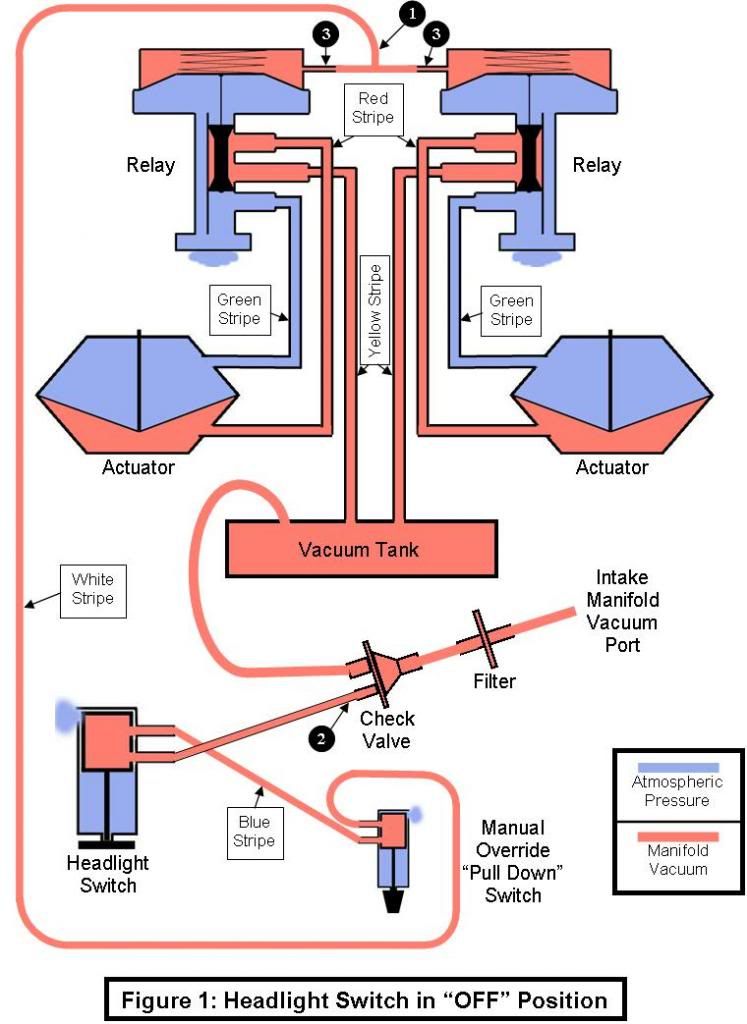

    When you turn the lights on does the switch open the vacuum or shut it off? I had my dash apart to fix the speedo and now my headlight doors won't raise. I hear a leak sound like at the switch. The hoses are on good. They worked fine before.

      When you pull the headlight switch out you are bleeding control vacuum off at the relay thus change porting of the muscle air to raise the headlight buckets. To close is the reverse you apply control vacuum to the relay to lower the buckets.

                  I do not know if you got this fixed or not. In answer to your original question, with everything set up correct, vacuum air holds the headlight doors closed. When you pull the headlight on, the vacuum holding the headlights closed is released to atmosphere. At the same time vacuum is applied to the two headlight relays, pulling the internal plunger and applying vacuum to the opposite side of the actuator opening the headlights.
                  Truth is, the vacuum at the plunger is what is actually holding the lights closed along with spring tension. When the switch is turned on it just releases the air on the vacuum side of the relay. This allows a different vacuum source to move the plunger. That vacuum is always on the plunger.
                  I can send you a really clear and easy diagram if you need it. At this point it sounds to me like the two hoses on your light switch are reversed.
                  The easiest way to tell if they are reversed is if you pull the light switch on and you hear a vacuum, but do not when it is off, your two lines are reversed.
                  Also, if your override opens the doors, but does not close them again, the two hoses on your light switch are reversed. EDIT; They will close again if the headlight switch is off. They will stay open if the headlight switch is left on.

                    Monte, that sounds exactly like what it is doing. I put the hoses on the switch like it appeared in the AIM but it seamed reversed from how it was before. I should have taken a pic but will reverse them and see. A better diagram would be nice though.

                      One has to remember there are 2 engine vacuum circuits and 1 electrical in the headlight door and wiper door systems.
                      1. Small hoses are for the control side of this operation.
                      2. Larger hoses the muscle side of the system.
                      3. Also small hose feeds the heating/AC and Astro ventilation system.
                      4. The electric side only deals with the wiper door.
                      The small hoses are for control the vacuum comes from the check valve then to the control switches whether it is the system switch or the override switch.
                      Control to close a system vacuum is sent to the relay valves small hose on the top this causes the porting for muscle vacuum to the closed side of the actuators.
                      To open a system the vacuum is bleed off the relay valve this allow a spring in the relay to shuttle or change porting to the actuator open side causing the item to open.
                      Muscle vacuum are the large hoses that comes off the check valve then to the reservoir tank and then to the lower sections of the vacuum relays for porting to the actuators.
                      In the wiper door system there is a electrical/vacuum solenoid behind the Tach. it is electrically controlled by the wiper switch porting vacuum to or off the relay valve to operate the door. You also have a override switch for manual operation.
                      The system is a fail-safe design that if you have a total loss of vacuum it will allow you to raise the headlights or wiper door manually.

                          Thanks guys. monte was right on about the Jose's reversed at the switch. For anybody searching in the future the AIM is backwards. Now you got me thinking about the wiper door. It has never opened since I have had the car. If I pull the bypass it doesn't open but I can pull it up and it will stay up and close when I push the bypass up. I started checking on this a couple years ago and realized some of the wires have been replaced. So I was just living with it. The biggest problem is if I turn the wipers on with the switch they try to come up with the door down. It's like the switch that is supposed to prevent this is bypassed. So I have two issues. 1door doesn't open. 2. Wipers try to run with door closed.
