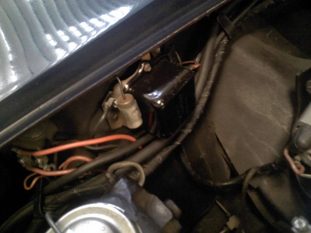

        Jack ,Are you saying that the edges of the covers would have paint on them ? Which in turn would cover the staples? Thank you all.

          Jeff. I just went out to look at mine. I would guess that the sides of the dust shields had some paint on them. I think they would have been hanging straight down before the body was mated to the chassis. With the body mounted, the positioning of the shields on the a-frames make the orientation different. Maybe someone else can chime in. I would say that the edges weren't fully blacked out. I included a pix of mine in the next post.
