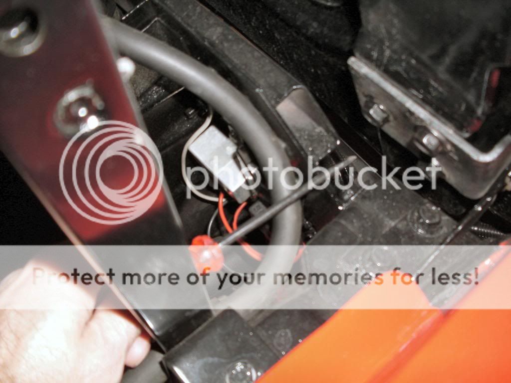

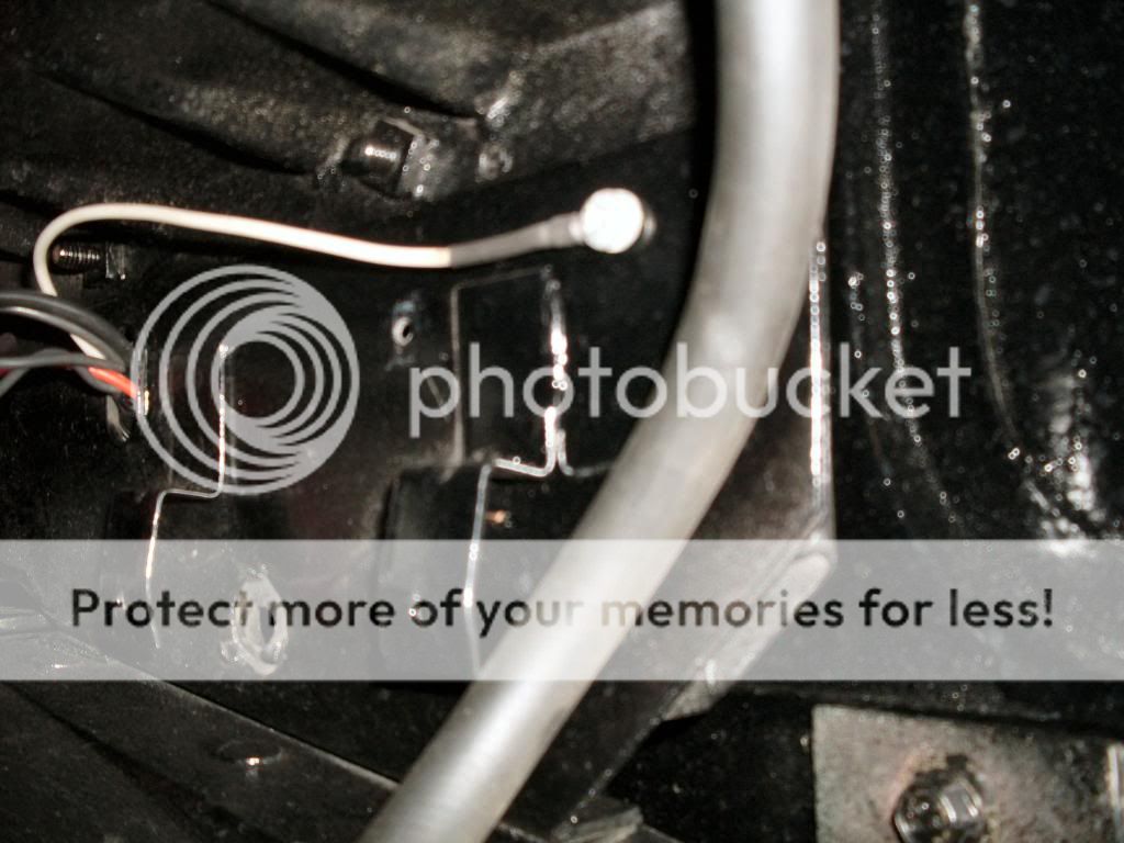

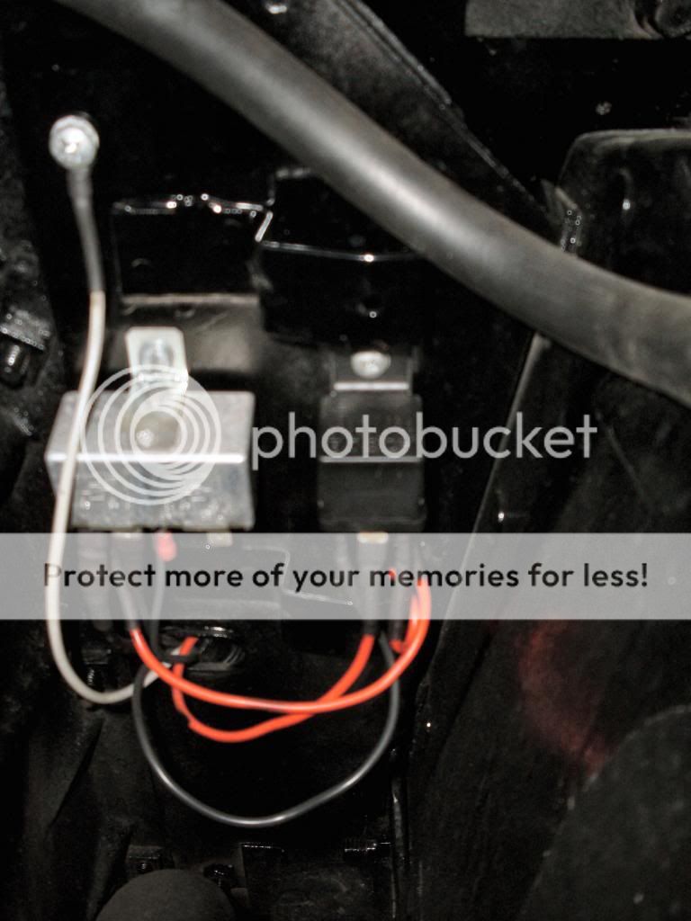

    Is this 2 brackets that is welded to the radiator support as you can see on the picture below where you attach the 2 brackets thats goes around the drier on a 64 coupe with factory air condition?
    The unoriginal wires was daylight driving lights lamps which i removed right after i bought the car back in 1993

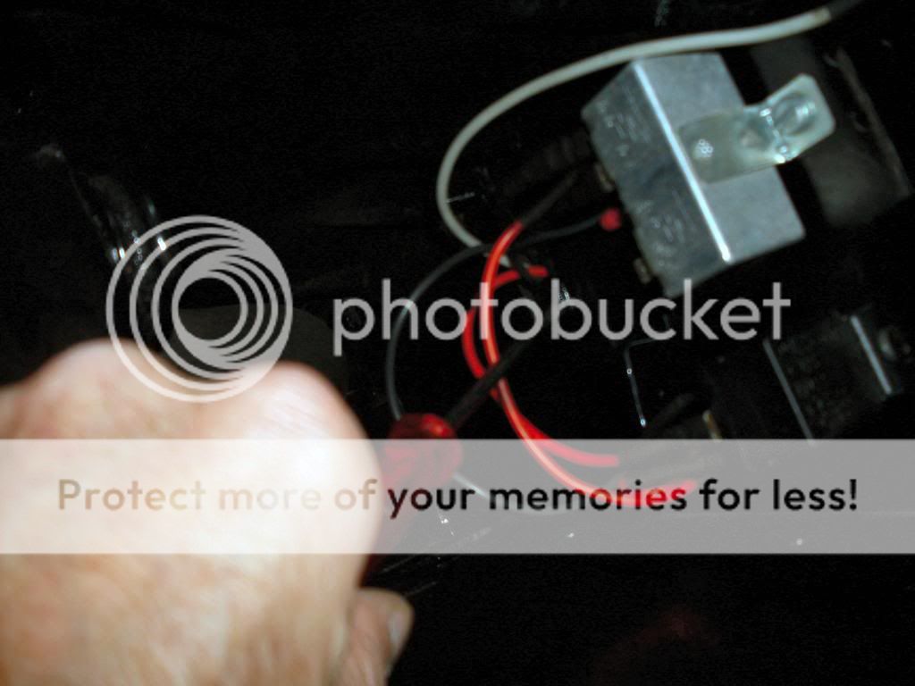

    Is one of the hoses from the drier to the condensor supposed to go over the radiator support while the other goes thru the hole in the radiator support?
    Like i have tried to show on the 2 pictures below
  • Wayne M.
    • March 1, 1980
    • 6414
    Re: Are this 2 brackets on the radiator support for the drier 64 coupe factory AC

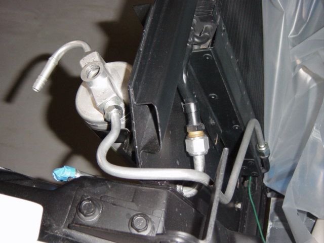

    Claus -- the answer to your brackets question and hose/pipe routing are correct. Pics from my early '65. Cap on Freon return line is to keep moisture/dirt from entering. I've never bothered to get my air conditioning working. The 2 brackets on the rad support are identical.
    • Mike G.
      • January 1, 1991
      • 418
      Roger: here's what my '65 tube routing looks like. Same as '64 I believe.
      Mike
