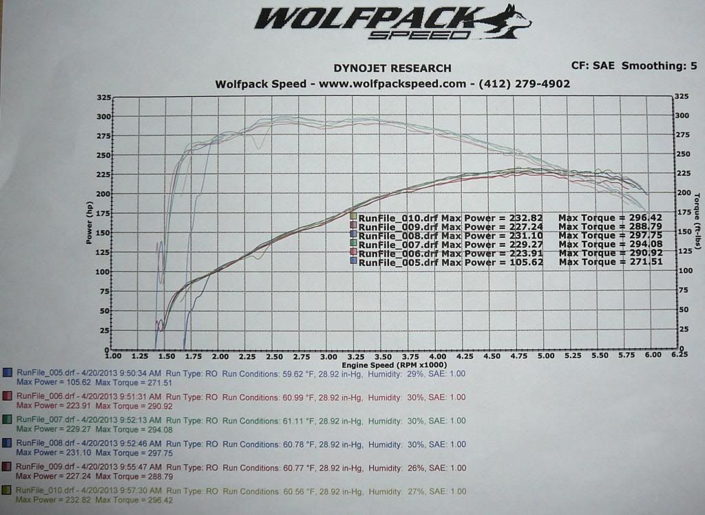

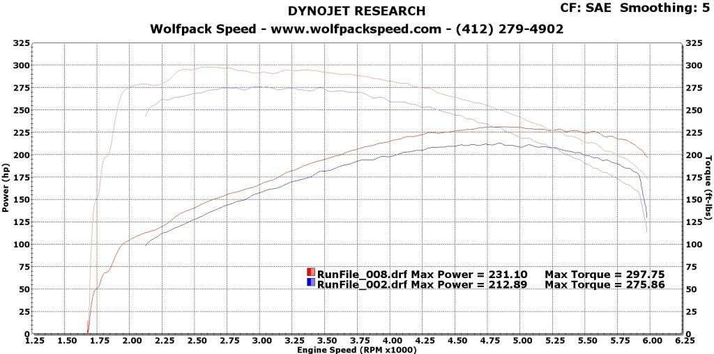

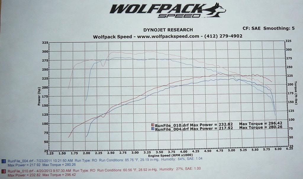

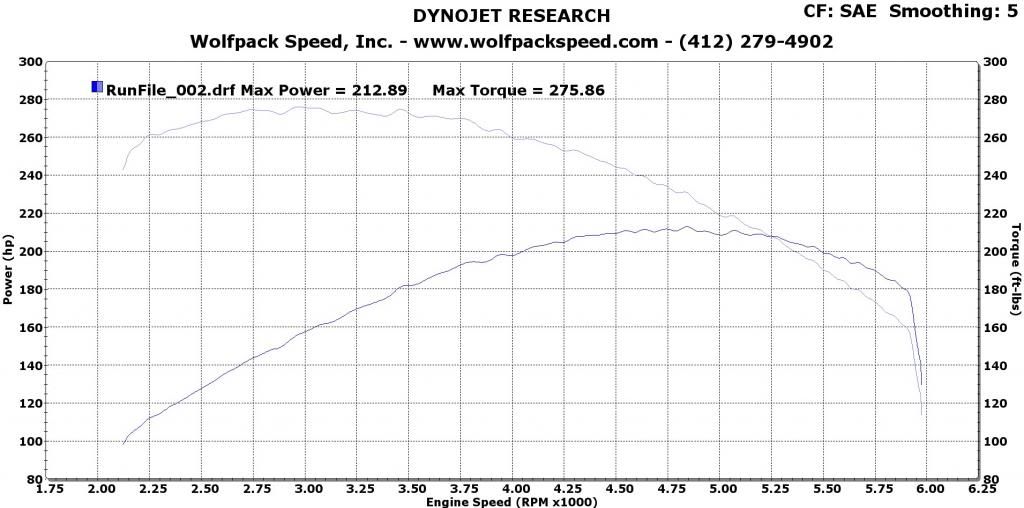

    Ran the car on the dynojet today. The numbers were a bit disappointing.
    The engine dyno lab results were accomplished with a velocity stack and open headers. The dynojet runs were accomplished with air cleaner installed (except where noted), stock exhaust manifolds and 2 1/2" exhaust pipes through mufflers. (Same as I drive it on the street.) Timing was set at 12' initial and is 35' at 2500rpm.

    This graph shows the old engine's best run with air cleaner installed.
    This graph shows todays runs 5 - 10. The dyno had a glitch on run 5, so it was aborted. Run 10 was accomplished with the air cleaner removed and shows a burble in the 2300rpm range. (I did not try to duplicate, the engine was making as much as it was going to make.) Runs 6 -9 are the clean runs with air cleaner installed. Run 8 producing the most power.
    This graph shows old vs. new with the air cleaner removed.

      This graph shows the best old vs. new engine with air cleaner installed.
