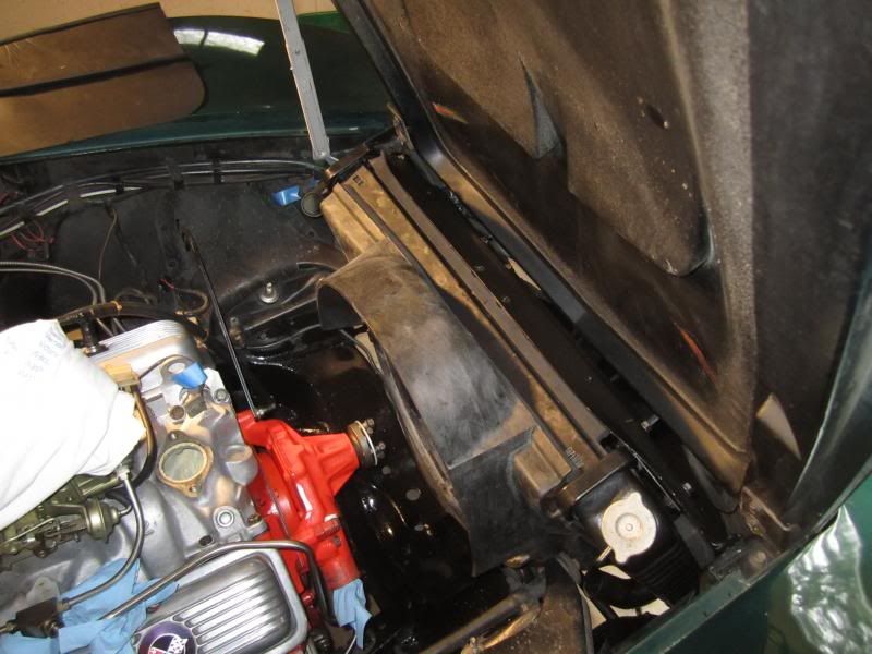

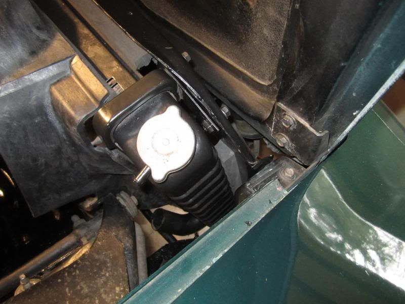

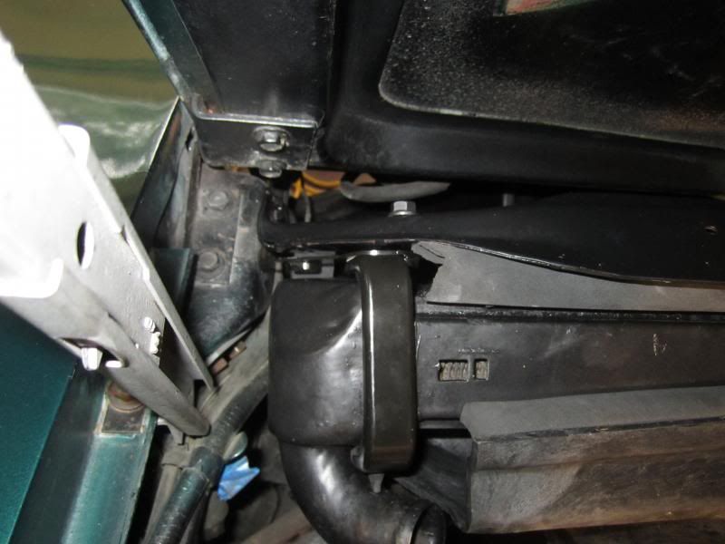

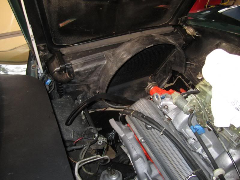

    I got a foam seal kit from Dr Rebuild and am having trouble getting the radiator to fit properly. It seems like the foam is to thick to get the radiator in and get the top clamps back on.
    I was going to try a different kit and would like to know if anyone has a recommendation. Looking for a kit that fits better than the one I have. The one I have doesn't seem to fit right. Before I lay out another $50 to a new vendor, thought I would ask you guys.
    Car is a 71 LT-1. This is a copper radiator car.

                Not sure I understand your problem? When I replaced mine I removed the hood (4 bolts), pulled the radiator/support (9 bolts), assembled the foam/radiator/support as one unit out of the car, then re-installed the radiator assembly. The new seals aren't compressed like the old one's, so it does take a little work to get it all to fit properly.
                In your picture it looks like the fan shroud isn't installed correctly (orange arrow) and the seal doesn't look correct either (yellow arrow). Was it cut? It should be square or rectangle when viewed from the end. If your radiator won't go down far enough, it may be a problem with the lower seal/shroud fit & alignment or the lower support rubber insulators.
                    I agree with Mike. Your seals are not installed correctly.

                      Yes, I had to cut the top seal to get the top radiator clamp on. The shroud is just hanging there. I'm not happy with how this turned out. I ordered a new kit to try this again. I'm going to trim a small amount off the top to bottom side seals to help the radiator seat easier. I think I'll also try to install the top and bottom foam after the radiator is sitting in the car so they line up better. I lined them up with the holes in the support, but the rad was pinching against the core and foam which doesn't seem right to me.

                        Are you trying to do this with the core support still in the car? If so, that is most likely your problem. With everything out of the car it goes together without needing to cut anything.
