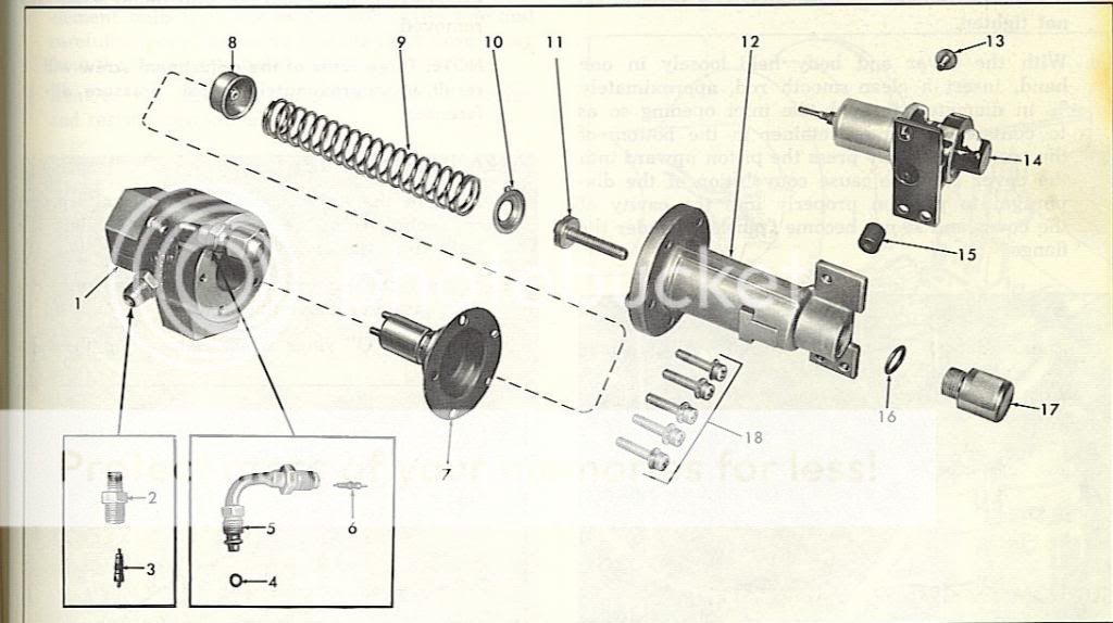

    It is time for me to restore the STV valve so i wonder if some here knows what kind of solvent i should i use to clean the STV valve?
    The GM instructions says to use Molykote Type Z.
    I have never heard of Molykote Type Z and i do not know what it is
    But from reading the GM instructions i guess where you use Molykote Z on the STV valve is where to use the graphite lubricant that came with the STV valve restoration kit?
    The GM instructions says to use 525 viscosity oil to lubricate the inside of the wall, piston and the spring of the STV valve.
    I have never heard of 525 viscosity oil so what kind of oil should i use? Can i use something like gun oil for that? Thinking that it is just for lubrication?
    The kit i bought to restore the the STV valve does not seem to include the seal that is located between the absolute vacum regulator and the STV valve itself(seal number 15 in the digram)
    Is there any members here that have restored the STV valve and knows if this seal for the absolute vacum regulator usually is included i kit?
    I do not feel for taking off the absolute vacum regulator if i do not have the correct seal(number 15) to put back on
    It looks like there is mostly O-rings in the kit i bought for restoring the STV valve, but the seal(seal number 15 on the diagram)does not look anything like a O-ring

    Re: How to restore a STV valve? 1964 coupe with factory AC
    Roger:
    Use the supplied graphite powder in place of the Molykote Z, which is a similar dry powder lubricant made by Dow Corning (difficult to get in a small quantity).
    If you are going to charge your system with R-12, you need the 525 viscosity mineral oil for lubrication. It's readily available from US suppliers of A/C related items. If you are using an original style A6 compressor, the system needs about 11oz of 525 oil for the initial charging. That's starting with a dry (empty) compressor. Use the oil to lubricate all the o-rings before installation, too. Do not use gun oil or any other type of oil.
    The seal for the vacuum regulator is not included in any kit I've ever seen. I don't think there's a danger of damaging it during removal of the regulator. You could smear a light film of vacuum grease on it for reassembly, to help get a good seal.
    For cleaning the body, after it's apart, a mild solvent and tooth brush should work for you.
    PM me if you have other questions once you get into it. Mike
