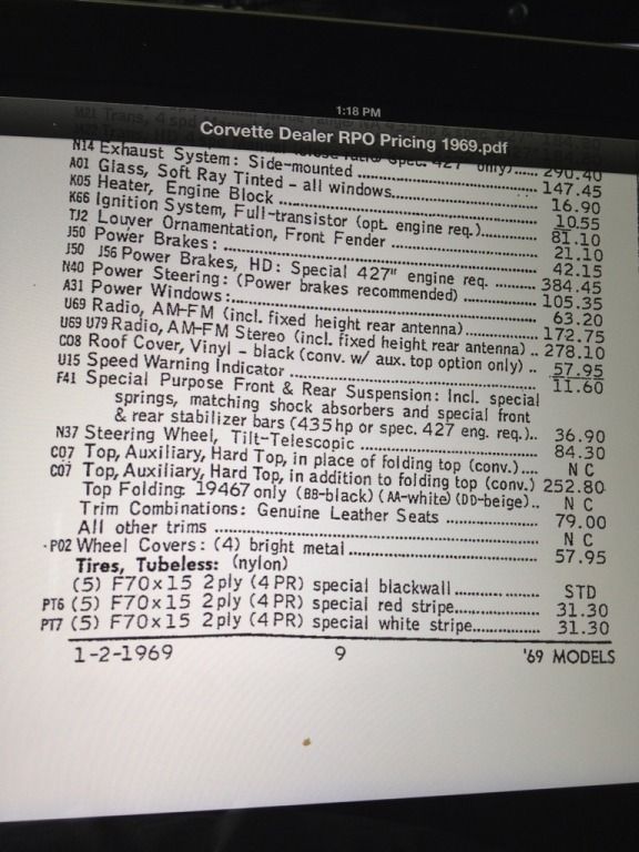

            1969 Dealer RPO Pricing Guide would contradict what you are saying. It says, C07 "in place of folding top"...N. C. (no charge) unless that stands for North Carolina :-)
              Mark------
              I can say for certain that the MSRP of a Corvette with a soft top only and one with a hard-top only was exactly the same.
