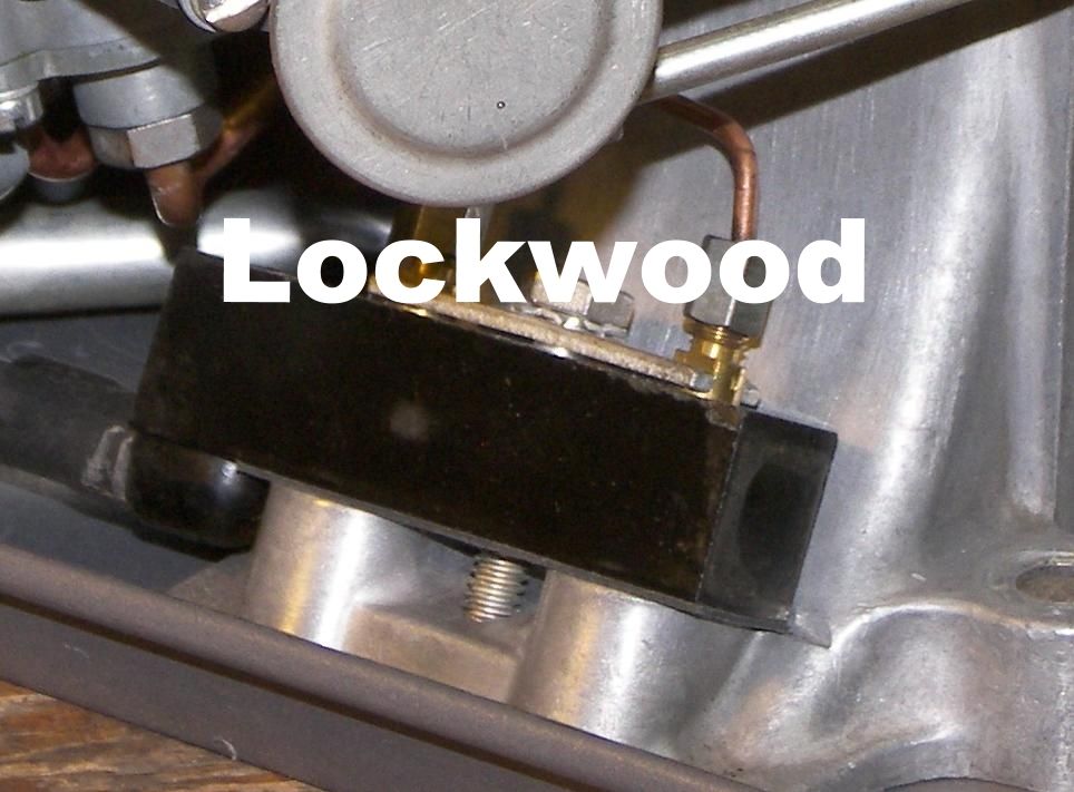

                    You need one with recessed nozzles blocks. No chrome except for the flag. John, What does a recessed nozzle block look like? I have an early 7017375 unit (#1449). I had to replace all the nozzle blocks but still have the ones that came in it and thought they were original. Thanks for sharing your knowledge! Don H.

                      Don,
                      What John is describing is the area just under the nozzle block. On early doghouse castings, there is a recess which lets you see some of the threads of the retainer bolt:
                      This area was built up on later castings, obscuring the bolt.
                      Jim

                        Jim, That's a first class pic there of the recessed nozzle block unit.
                        The early recessed nozzle block plenums had 2 bosses on each end of the plenum. If you had a radio car the rear two bosses were removed. By November 62 no more bosses sticking out the front of the plenum.
                        A little know fact: All the 63 to 65 plenums (except the sand cast one ) had the 4 bosses. We call them bosses but in fact they were used in pouring the mold for the casting. So from Nov 62 till the end of production the bosses were machined off.
                        Refer to posts here from a few months ago by Robert Boutot concerning the same subject for his Early 63. JD
