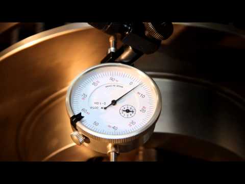

    The last time I had my front rotors turned on my '65 was about 34 years ago at the time I was told they were at the min thickness so I thought I should replace them while I’m restoring the chassis.
    I wanted to retain the OE rivet look even though they can't be seen and found a set of rotors from Zip that had the rivet holes machined into them however after installing them I checked the run out and it was a disappointing .011” see the video below.
    I could have the rotors turned with an on car brake lathe but really didn't want to remove that much material from the rotors. I checked and NAPA makes a shim plate that would correct run out to about .009” tried to order, but found the only ones available would correct .006” I actually ordered and thought I would try it to see how close I could get and it didn’t do much good.
    I did some internet searching and found a thread where Gary Ramadei did the corrections by making shims from shim stock so I thought I would give it a try.

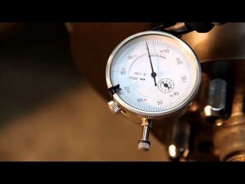

    Gary didn’t post any pictures of his shims so I guess this is my question. The image below shows the shims on the hub prior to rotor installation. Does this look ok?
    After dialing in the shims the best I could get was about .0015” of run out but I think that ‘s within spec.
    So then to install the rivets. I used the same method Tracy Crisler used to install ball joint rivets. Heating the rivets with a torch till they were red hot on a bucking bar and forming the back side of the rivet with a 9X gun.
    Mike

    Re: Shiming Front Rotors. Is this Ok?
    Mike,
    Looks like you went the extra mile, looks good in my book.
    DOM
      Very nice job indeed!
              Mike
              You did a real nice job, 0015 runout is very good. I shoot for under .002" so you shouldn't have a problem. I just use SS shim stock, I don't cut them as large in diameter as yours and usually only have to shim one or two studs.
              I'd like to see your rivet install method if you have it on video. They look real good. I usually bolt them on for easy removal if needed, which would be in the rear arms anyway.
              I've shimmed new and used rotors for years and never had a problem once dialed in.
                  Mike
                  Unfortunately I didn’t take a video of the riveting. I followed basically the same technique that Tracy Crisler outlined in his procedure on installing ball joint rivets.
                  I used a long bar in this case the bar was flat and clamped to a workbench. I placed the rivet on a solid washer about the size penny. Heat the rivet till it was red hot, then grabbed the rotor hub assembly placed it over the hot rivet then used the rivet gun to form the rivet. You also should cover the wheel bearings because when you drive the rivet home small shards of steel flake off the rivet and you don't want to get those into the bearing.
                  One note I forgot to mention in the original post: The rivets alone DO NOT clamp the hub tight enough to the rotor to maintain the same run out. You must torque the lug bolts then check the final run out.
                  I'm not sure I'm up to doing the rears this way too because you would have to put everything together get the end play right then take it all apart to check run out which could be off a little by bearing the end play then rivet the rotor to rear spindle then put everything back together. Will see.
