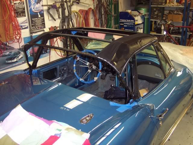

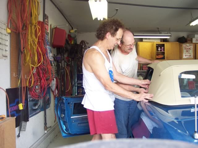

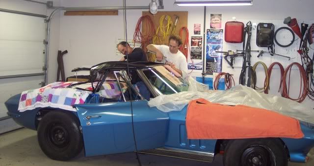

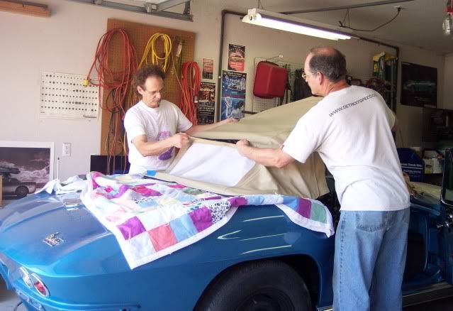

              Nothing ventured............I did my own 2 years ago after getting guotes from $450 to $650. Most shops don't see one these (mid year) tops once in a 'blue moon' so the decision was made to install my own. After purchasing a Knoch top, rented his top install video (invaluable). Two days later...botta boom, botta bing, done! If you have the skill set, it's a doable project. Take your time, measure twice, cut once. During judging my top compared equally with any of the "professionally" installed tops. As mentioned when purchasing you'll be getting the 1/2" bead piping across front of top. If you want "correct" you'll need to ask to the 3/8" piping considered correct during judging.

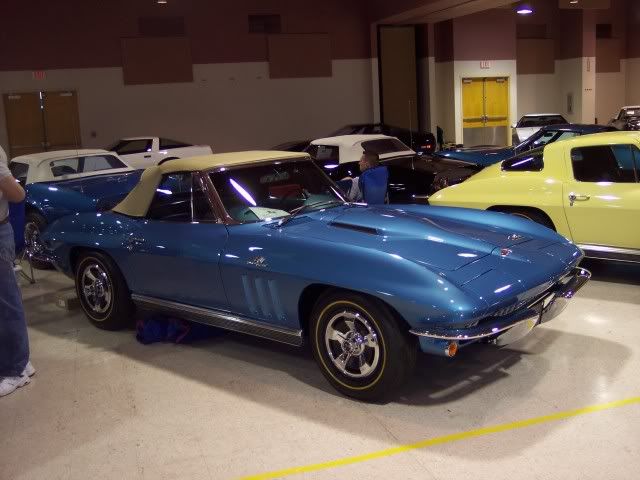

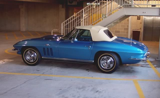

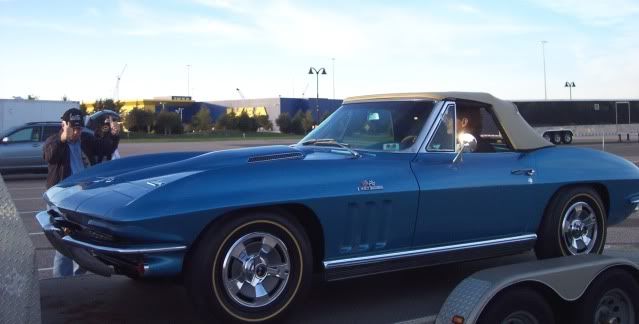

                    Thank you for the compliment. Let me encourage you to go with tan, less than 500 got the color in '66, probably the same for your year. Minimal upkeep. Tan would look great with green. Black being dark would feel it's going to show most everything being (no disrespect to you dark top guys ). It's been a novelity to have a top this color as most are white, then black.
                    Pics were taken at the Joplin, MO Regional 2011. 1st time held there in many years....unsure if event center was wiped out in the Joplin '11 tornado. So that you can get the gist of top installation realizing you can do the same for yours, here's a few taken at the Frisco, TX Regional Oct. '11.
