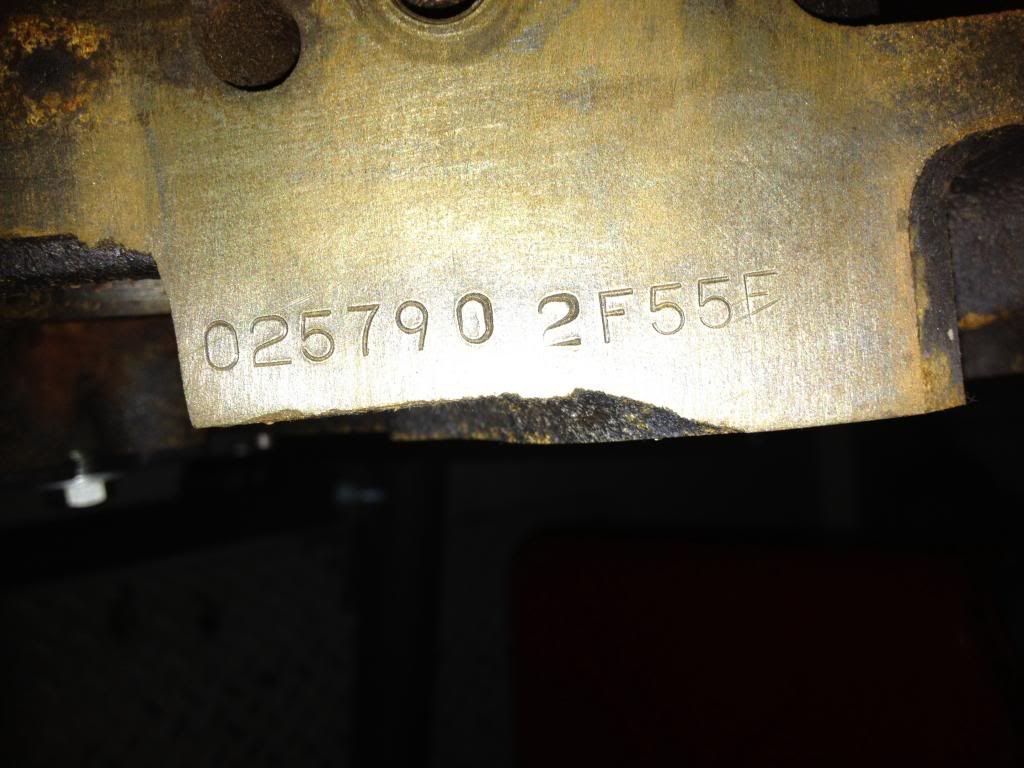

              Here are several 55-56 Flint two barrel passenger car pads.
              Hinkley has a pad picture of a 56 Corvette motor that I sold. If he reads this maybe he will post it.
              Regards
