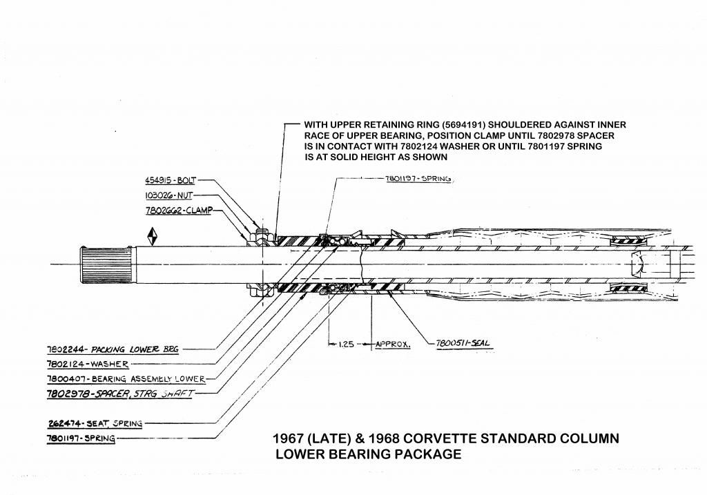

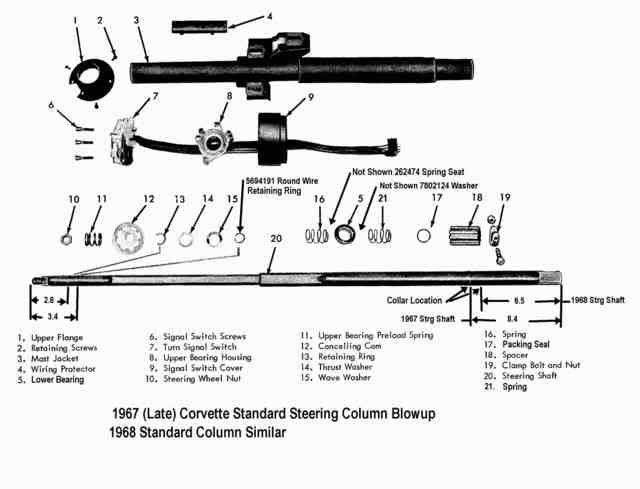

        You didn't mention if you have a standard (non-adjustable) or a telescoping column. They both have the same reason as to why the steering shaft will not just slide down and out through the lower bearing. There is a small collar welded? to the shaft just above that lower bearing. As long as the whole lower bearing package will slide out of the steering column jacket and slide out WITH the steering shaft. You should be able to slide the shaft down and out through the steering column. Otherwise, the shaft should come out through the driver end of the column.
        The bearing package is somewhat different between the two columns.
        The late 1967 and the 1968 standard column has the bearing pressed directly into a counterbore in the jacket. There is a small spring between the bearing inner race and the welded collar on the steering shaft. This entire steering column blowup shows the order in which the lower bearing package goes together on a standard column. I will try to supply a better scan shortly.
        The late 1967 and the 1968 telescoping column has the lower gearing held in place by a cup shaped retainer. The retainer has three screws that hold it in place on the steering column jacket. It looks as if the bearing sits directly against the steering shaft collar. Remove the three screws and the retainer and the bearing should come out of the jacket (except for corrosion problems.)
