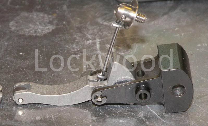

          If your unit uses either an original GM axle and link or one of the replacements held together with dabs of epoxy, like this:
          .....buy a high quality spare that's held together with little "C" clips, like this:
          What else? Buy a rebuild kit only when you really need one. You'll get the freshest diaphragms that way.

              Lockwood, Nice pics. The epoxied link is a nice touch too. I guess a car owner could do that since it's his baby and he has no one to answer to my himself. But to sell those to the general public is questionable. Whew!!!!
                  You like that gravity-defying counterweight?
                  Here is a helpful(?) consumer tip: An engine with an FI unit with an epoxied axle and link that doesn't move freely will start and run (sorta) as long as the cold enrichment is on. When cold enrichment turns off, so, too, will the engine. It will not re-start until the engine cools sufficiently for cold enrichment to turn back on.

                    hey jim,
                    Where can I get one of those improved axle links, or is that your own design?

                      hey jim,
                      I wish it was my design, Ian. It is extremely well thought out and it fixes all the issues with the original GM pieces. It's so well made that you'll never wear one out.
                      You can get one by giving John DeGregory a call. He's too modest to tell you that, but he's your source.
                      Jim
