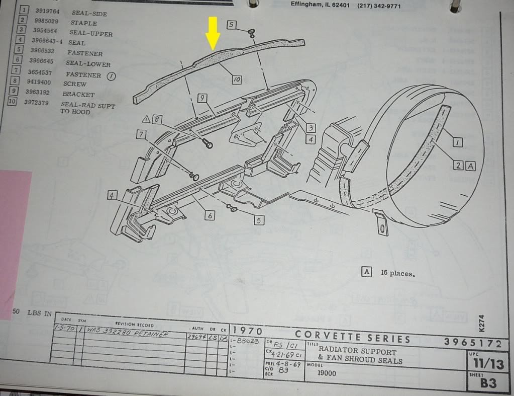

    Which is correct for a 70 L46, copper rad? Single piece or three piece?
    AIM
    Repro catalogue, item G
