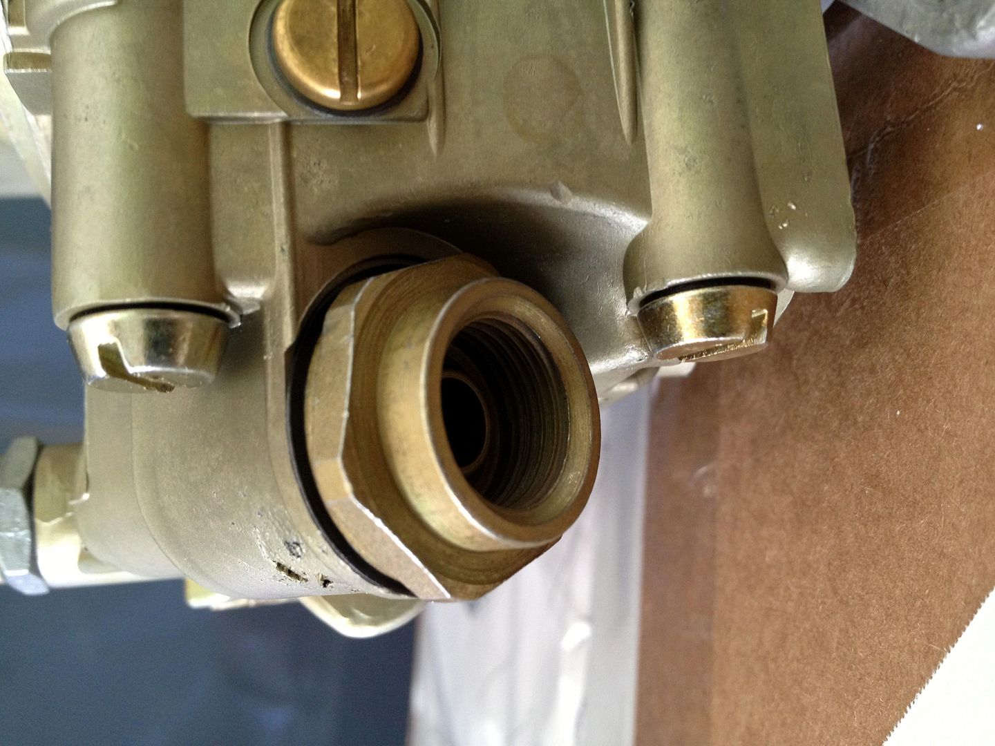

    Corvette Central has them under their part number 352201 for $10 each. The Mopar fittings are much more servicable on the car but are not correct for the Corvette. You might be able to modify a box wrench to work with the carburators in place but I have found that you'll have to remove them to tighen or replace the fittings.

      As far as coloring, they most certainly are correct. Some folks are under the impression they should be black/dark phosphate on these and that isn't correct. The ones in Wayne's pic are certainly faded (color) with age but are otherwise correct.
      As far as typical configuration, this is correct...

        Thanks Mike
        I'll send the ones I got from Summit back and order them from Corvette Central.
