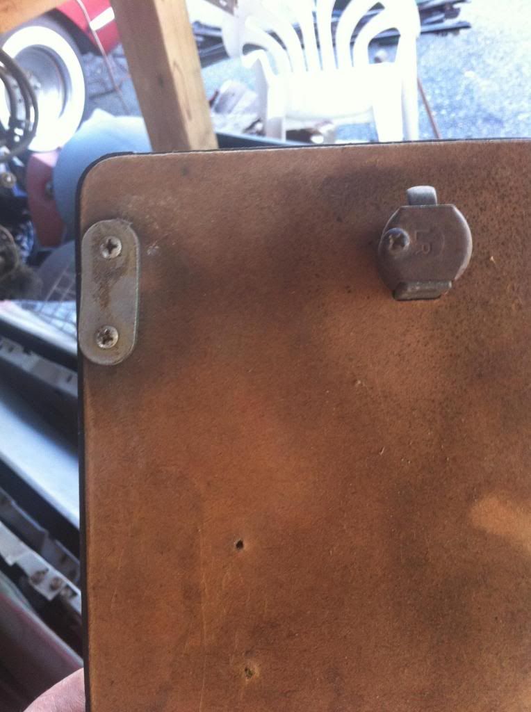

    On center storage door, contacts light plunger.
    Is this stock, or added?
    Only one I've ever seen.

              Re: Is this a '68 only part?
              Here's the other side--stamped sp
                In the new TIM&JG, Chevrolet Dealer Technical Service Bulletin No. 68-T-57 (July 12, 1968) discusses these parts under the heading of "Center Stowage Compartment Door - Hard to Open". As I understand this section, 3941908 refers to the "rigid masonite center stowage compartment door" and 3937942 refers to the new "lock retainer". There is no mention of the "shim" pictured by George Wright. I can't find mention of the shim anywhere.

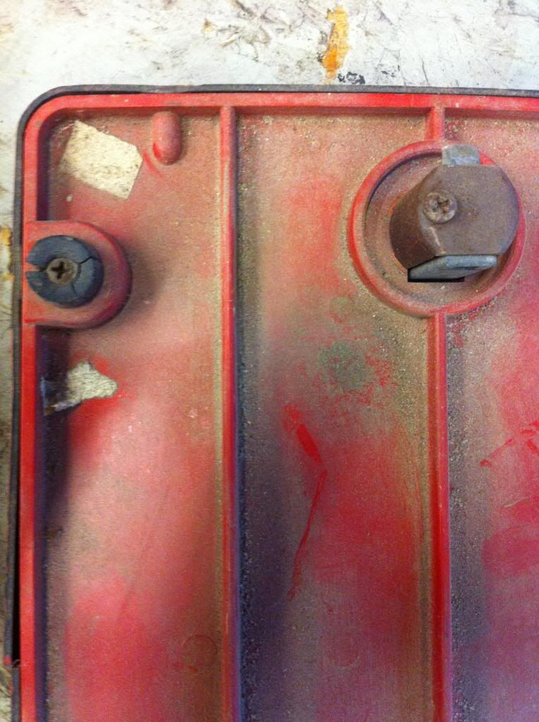

                  Interesting.
                  Below is a photo of the center compartment door from my Mid March built '68. The other two doors are the Masonite material.
                  I have no way of knowing if this plastic door was original to the car, but everything else on this car (including tank sticker) looks to be as built by the General.
                  Wonder if these ribbed plastic doors were in GM stock for a period of time, and maybe the "bumper" was added?
                  G.
                    I have a January 22 built car and it has the hard plastic door. Warped like the rest.
