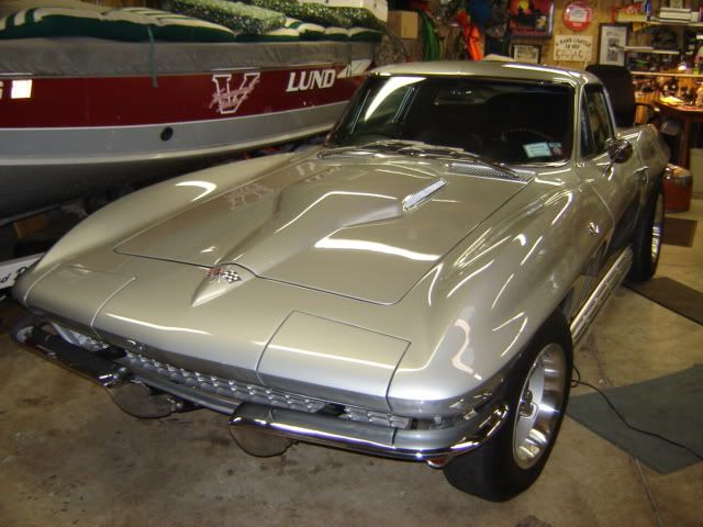

      Looks like this.

        Hopefully the OP has the correct 65 grill.

            The car is a '66. Thanks for your input though.

                  Are you saying the '65 and '66 big blocks did not have the same "power bulge" hood?

                    The '66 hoods (both flat and BB) should have the Corvette emblem at the left front corner.

                      The bulge is the same but 66 hoods have the Corvette emblem on the left front corner and also have the recessed areas on the underside for the attachment nuts unlike 65 hoods. Yours doesn't have the emblem so I assume it's a 65 hood.
