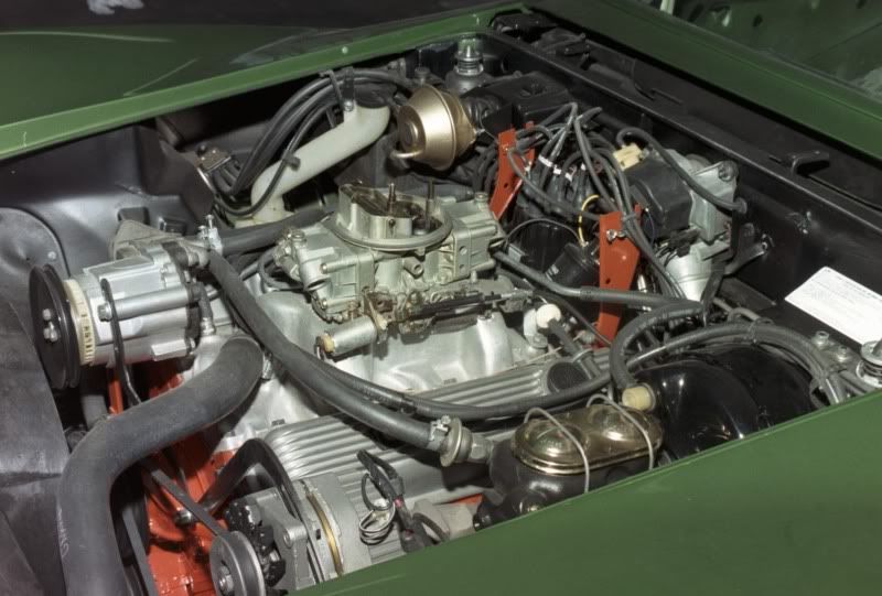

      This is the TCS solenoid on a 70 L-46. The TCS relay is mounted on the bulkhead, just to the right of the wiper motor (looking aft).
      72 LT-1, http://www.corvettefever.com/feature.../photo_01.html

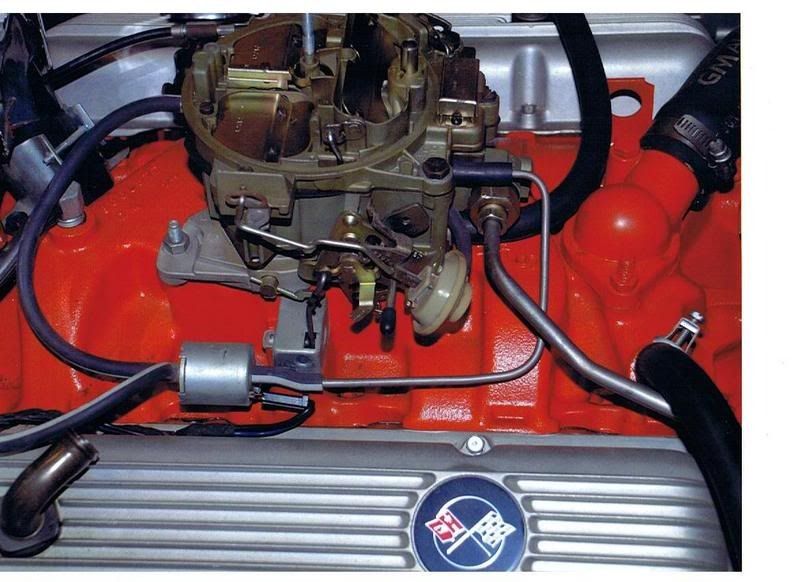

          Jim, since my '72 is a L48 and not a LT-1, your installation will be slightly different than mine, notably due to the location of the vacuum port on your Holley carb. That said, I attached a file photo that "sorta" shows my TCS. This photo at least shows you the TCS canister, the grey foam muffler/filter, the electric supply and the vacuum "plumbing", which runs from the carb's vacuum port, through the TCS can and then to the vacuum advance canister. I hope this helps you in some way.

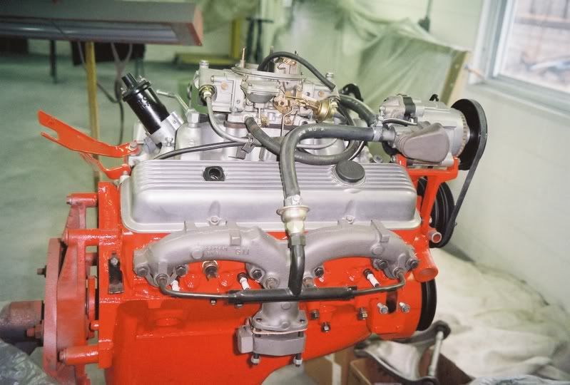

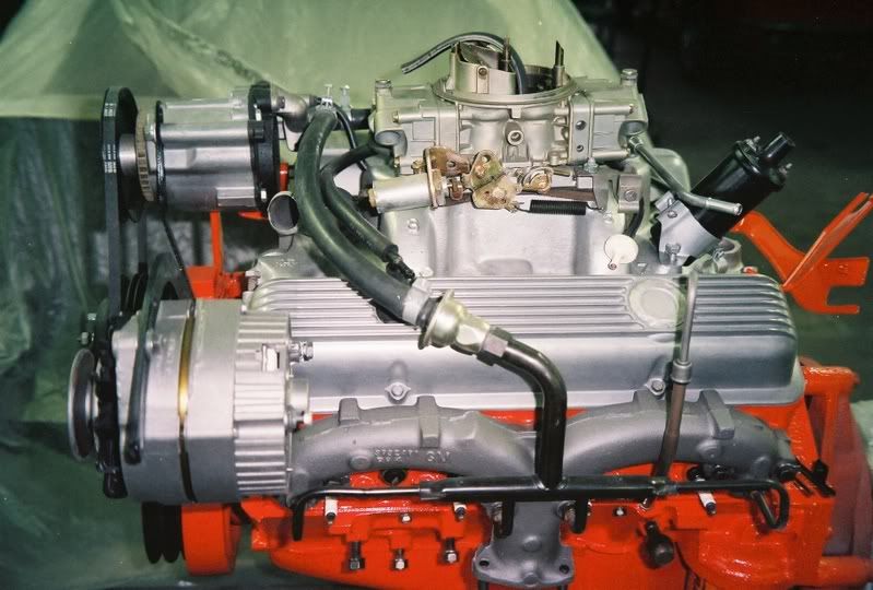

              Jim, cant't speak to how 'correct' this is, but, here are some pics of mine. 1972 Lt-1 no air conditionining
              Regards
              Roy
              yes I know my valve covers are on the wrong side in the engine only photos, hope these help some

                        Thanks Roy, Nice looking engine in your engine bay of your car.
                        Those pictures are very helpful.
