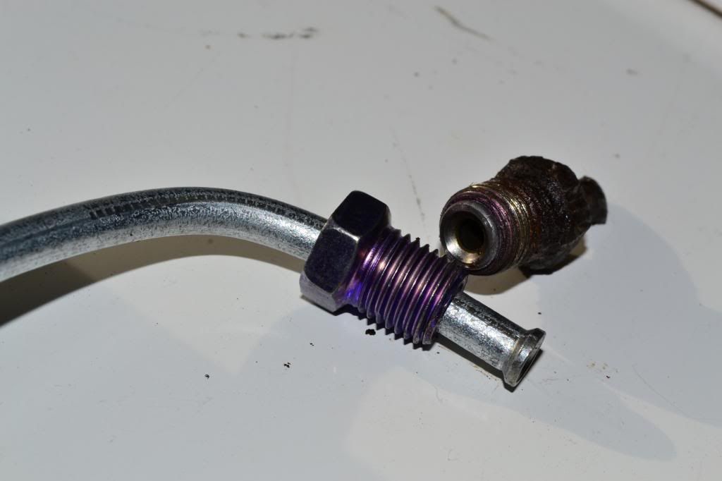

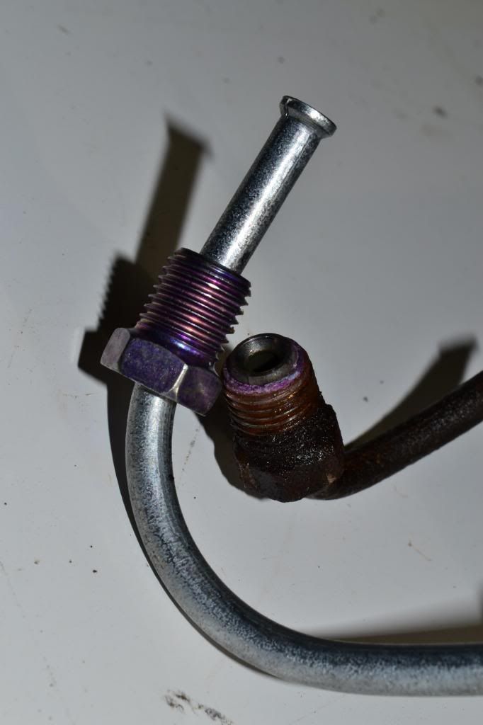

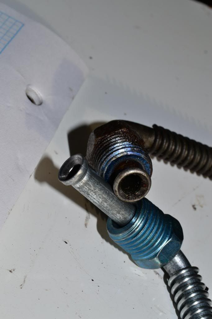

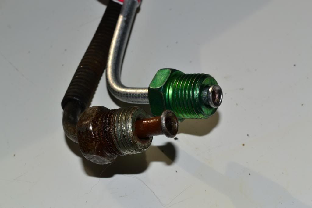

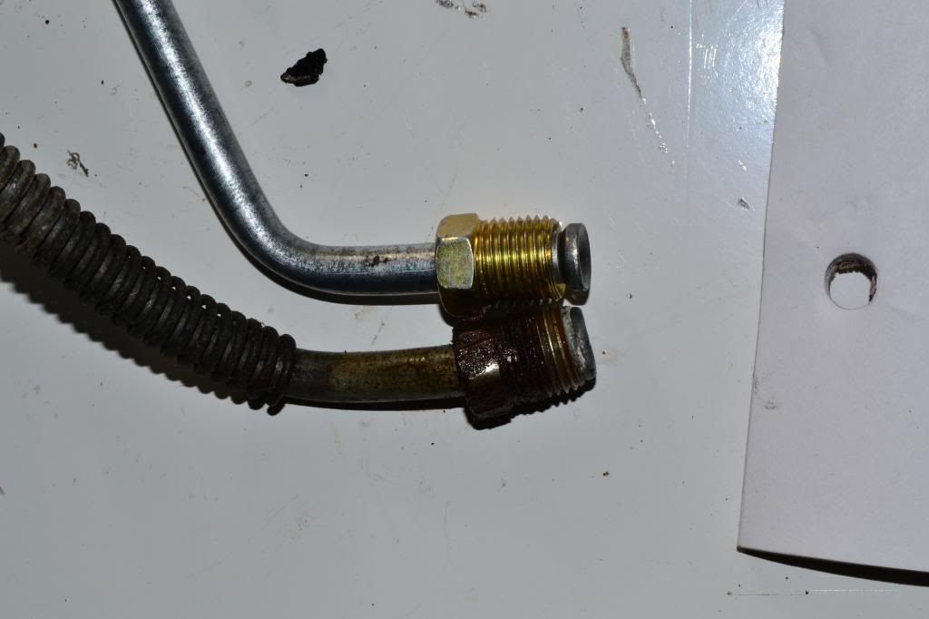

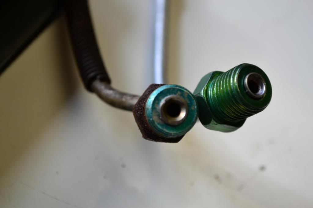

    I received the power brake kit from Zip for my 1975 corvette from an astute family member, but I had questions about how they stacked up to original brake lines and how they would score. Generally, the bends are "close enough" that some minor tweaking can get them to match the existing. Where I noticed the biggest differences were the colors of the fittings around the proportioning valve and master cylinder, and the armor "style." My original brake lines are my only sample to which I can compare. Below are some pictures comparing the old and new fittings, as well as the armor.
    Front master cylinder brake line (master cylinder fitting) - The line fitting from Zip is too green. Original fitting is more of a blue-green.
    Front master cylinder brake line (proportioning valve fitting) - I have a hard time determining if the original fitting was green, or left a natural brass color. All of the original fittings I looked at retained their color on the thread, I have a hard time believing this one fitting lost all its color. Also, the other master cylinder brake line left the fitting that connected to the proportioning valve a natural brass color.
    Rear master cylinder brake line (master cylinder fitting) -The fitting from Zip is too light. I would describe the Zip fitting as a UNC blue, and the original fitting as Duke blue.
    Rear master cylinder brake line (proportioning valve fitting) - Fittings appear to match as a natural brass finish.
    Proportioning valve to rear brake line (proportioning valve fitting) - Same blue as the rear master cylinder brake line (MC fitting). I would describe the Zip fitting as a UNC blue, and the original fitting as Duke blue.
    Front right brake line (proportioning valve fitting) - The purples appear to match very well.
    Front left brake line (proportioning valve fitting) - The purples appear to match very well.

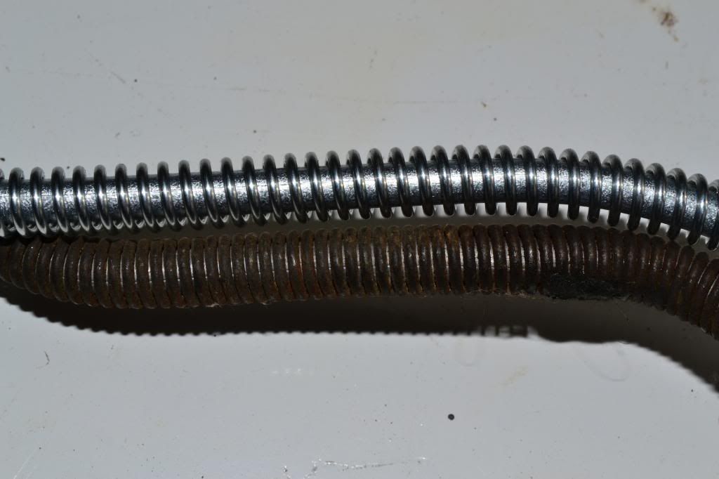

    Front master cylinder brake line - Armor too short
    Rear master cylinder brake line - Armor too short
    Up-close armor comparision - The armor is too spread out, and from the previous armor pictures, it was already too short.
    I have not attended an NCRS judging event yet (the national convention will be my first), but I would expect there would be a deduct for the incorrect fitting colors and the armor not being completely correct. I would love to hear the opinions of those who have judged the 1973-1977 mechanical section. At this point, I plan to use the Zip brake lines. If I miss a flight award because of a few points, then I obviously have many other incorrect items.

    The armor configuration is not any different with any other manufacturer. So, you will not gain much by looking elsewhere.
    I have not seen "better" colors than what you have there. I suspect that most manufacturers won't care, and the hit in judging is minimal, if any.
    Note that your car must be judged at a Chapter or Regional Meet before it can be judged at a National Meet. Perhaps you missed that, or perhaps you only plan on attending and not having your car judged.
    I just thought I'd point that out in case you planned on the National as the first event for your car.

      What I did on my 72 was, on the new lines pick the end that has the straightest and longest on each one. Then I cut the 1/4 flare off of it. I took the time to straighten them out just a little bit. I then cut the old lines however I needed to get the old insulators off. I sent the insulators out to be replated. I then took the insulators off the new lines.
      Now you have your old insulators replated in front of you with your new lines with one end cut, one fitting on the opposite end, and no insulators. Take your old replated insulators and slide them over your new lines, put the fitting back on the end you took it off of and reflare the end again.
      They look just like the originals with the exception of the colors on the fitting being a little off.
      It might sound like a lot of work, but compared to what we do to other parts to make them look original, it is not so bad.
      This looks far better than just replacing the old lines with the new.
      I hope I explained it well enough so you get the just of what I was trying to say.
