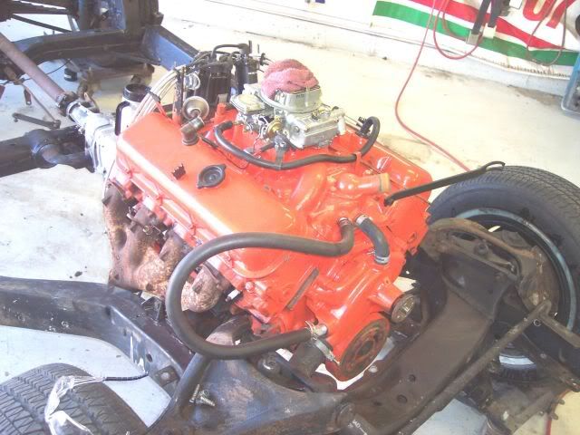

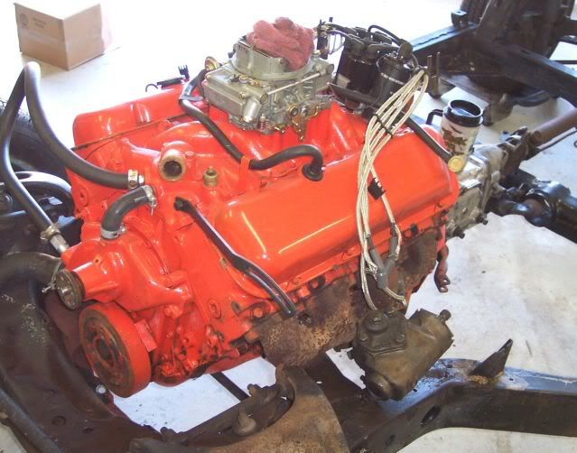

    Larry,
    My Sept '65 built 390 HP engine has both brackets. Obviously cannot state they came this way however both brackets appeared to have the same age and wear as other components on the engine. Not that it means a great deal but the car has been through regional judging twice. Nothing was called saying brackets should've been there.
    Pics of engine just after body was removed. Both brackets are in view.
