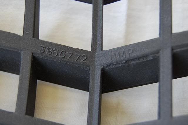

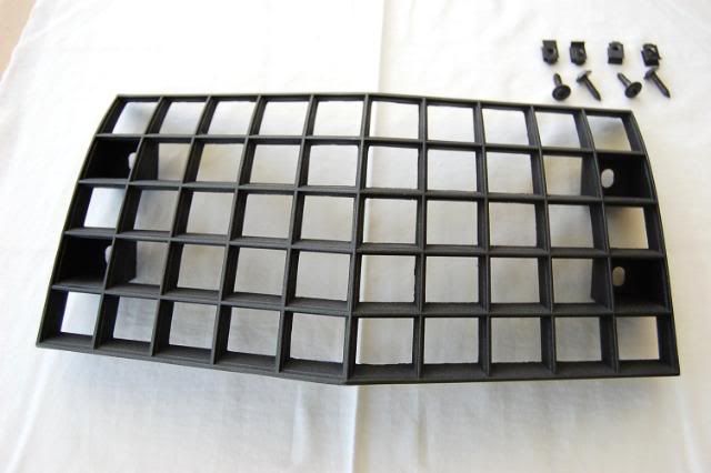

    Hello everyone,
    I sent my grilles out to be re chromed and painted and they are now finished. Before I accept them I was hoping an experienced eye would take a look at the attached photos and let me know if the paint color is correct. The TIM&JG calls for a "gray sand cast finish". Most of the grilles I have seen appear closer to black than gray so I am interested to find out if this color is correct.

    Re: Reconditioned Grilles
    Gene
    The gray finish looks to be smoother and a bit lighter than I have seen. The center grille section should be black as I recall and the two side pieces with the parking lights should be gray. I'm sure Terry M or someone else with more experience than I can chime in with better advice.
      Originally posted by Bob Demmel (27621)
      Gene
      Bob
      I tend to agree with Bob. The paint was originally lacquer and was almost textured and a bit rough. I had paint custom matched to my original which was in very nice shape. From cleaning over the years it tends to get smoothed out. The center grill on mine was relatively untouched and the "texture" was quite evident. I used the center grill for the paint match. My paint guy had the original formula and even then it needed a little adjustment.

      • Eugene V.
        • August 21, 2011
        • 85
        Bill and Bob,
        Thanks for your replies. It looks like they are going to have to be repainted.

          Found some pics.

                        • 3422
                        Hi,
                        This is Eastwood Zinc Phosphate 10281Z spray can.
                        It has a rough texture when sprayed on the center grill casting.
