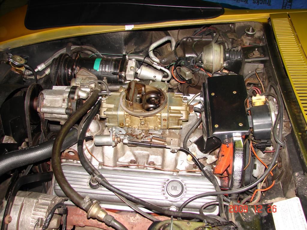

                      Hope these help.

                            Nice pictures Kevin -- thanks. The LP in the second image is likely the identifying stamp of the UAW worker who hot tested, balanced and set the timing at the hot test station in Flint. I was told that each worker at this station had an identifying mark on a hammer and after they performed the above tests and adjustments the marked the engine so that if there were future issues the worker responsible could be identified. Among the marks I have seen initials are unusual. More often there is a symbol of some kind, and the location is all over the intake.

                              Some pictures:
                              1972:
                              Interesting to note that Kevin's 1972 as well as this above shows no silver paint on the attaching bolts, and that argues for no paint in 1972.
