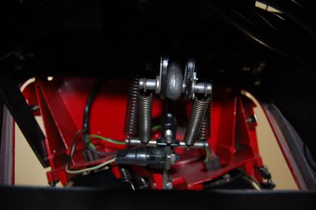

            So can anyone assist on where to mount these strips? I know they go to the left and right of the headlight openings but since they're not depicted in the AIM, I don't know how close or far to the headlight openings they get bonded. Thanks for any replies.
              • 3422
              Re: 68 Top Surround Reinforcement Strip
              Hi Michael,
              On my 71 the strips are about 1/4"-3/8" away from the edge of the surround opening.
              Hope these help. Right-side door first, then left-side.
                Alan, that's perfect. Thanks so much. As long as this board has been going and as deep as the archives are, I couldn't find any discussion of these bonding strips in the archives. I hope this will help others in the future. Thanks to all for your replies.
