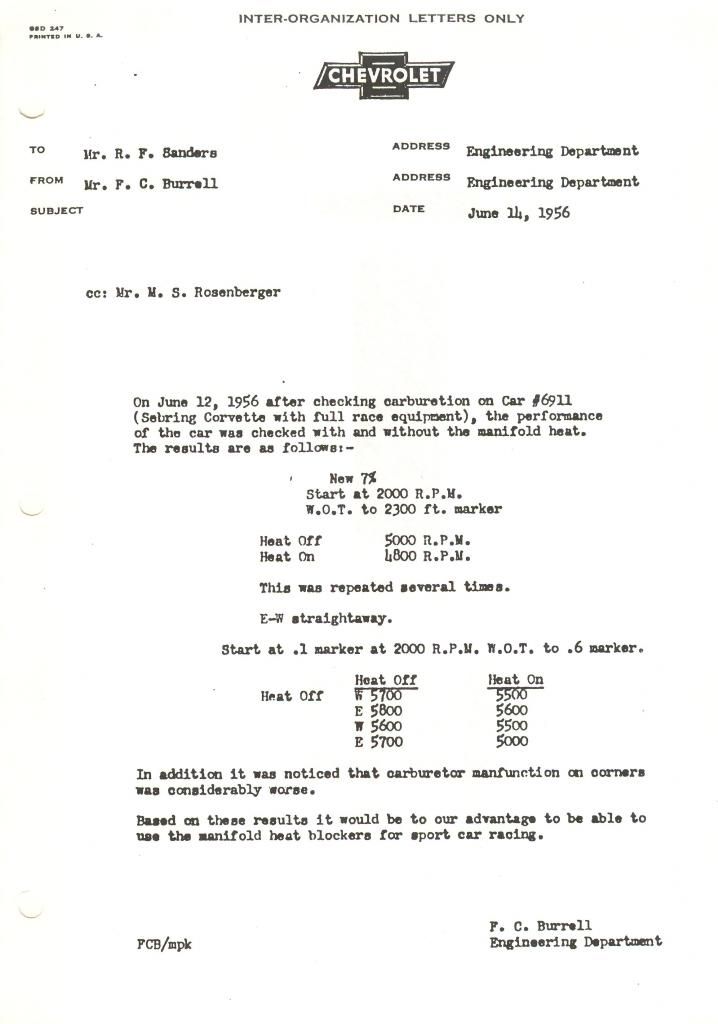

                Here is blocked heat riser test results by Frank Burrell in 1956 with 1956 Sebring Team Car #7 (Engineering Number 6911) which Sally and I own. I believe (by memory) that the heat riser blockers were in place on the 1956 SR-1's produced at St. Louis in June 1956. They may have been included in an envelope with other C-1s from the factory. I kept the heat risers blocked and the chokes inoperable on my 57 270HP and my 62 409HP that I own. The cars were used for extensive legal and illegal drag races in the late 50's and early 60's.

                    some of the dual carb corvettes came with a envelope with the block offs included.
