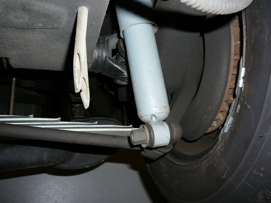

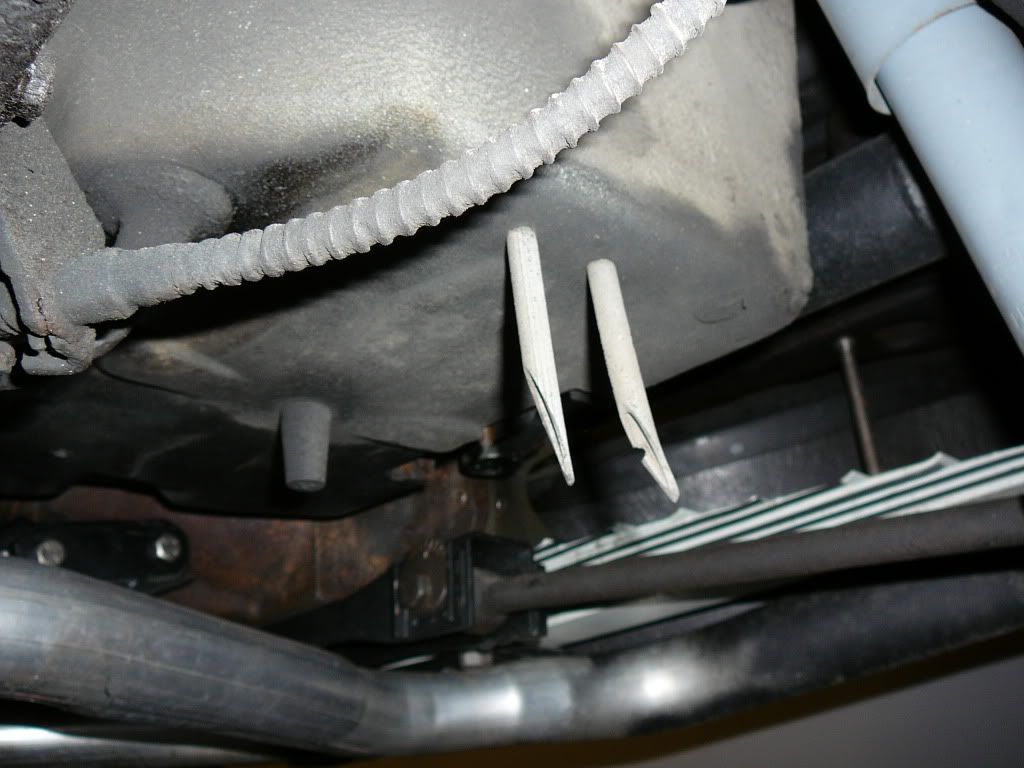

                  Whether or not they were intended to face rearward, the AIM fails to show any detail regarding orientation of the cut that I could see. Right or wrong, mine face reward. I've attached a photo that I took tonight, standing under the center of the car, looking outboard. You can see that the ribbed vent tube is in the aft position. Smooth in forward position.
                  Frankly, I struggle to see how the line operator(s) would spend the time it takes to ensure specific orientation of the beveled cut, regardless of work instruction or spec, no? Does anyone know the elevation of the body during this part of the assy. process?
                  BTW, Jeff - if it helps, I also measured my vent tubes tonight. ID = 1/4". OD = 3/8" (both tubes).
                  Hope this helps...
                  Don
                  The angle cut of your hoses do not look typical factory just my observation.
