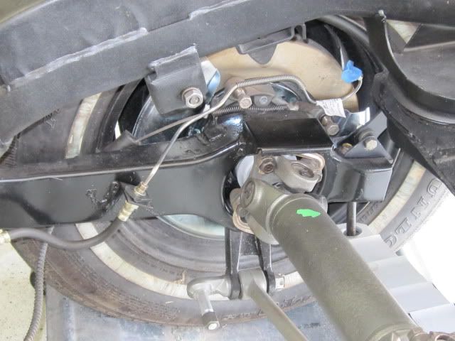

              • Lawrence S.
                • April 1, 1993
                • 801
                Re: 67 BB Halfshafts
                I did not use the brush or anything abrasive on the half shafts. I painted the green daub on the half shafts and then sprayed them down with Boeshield which "grays" them very slightly. I will post some pictures.
