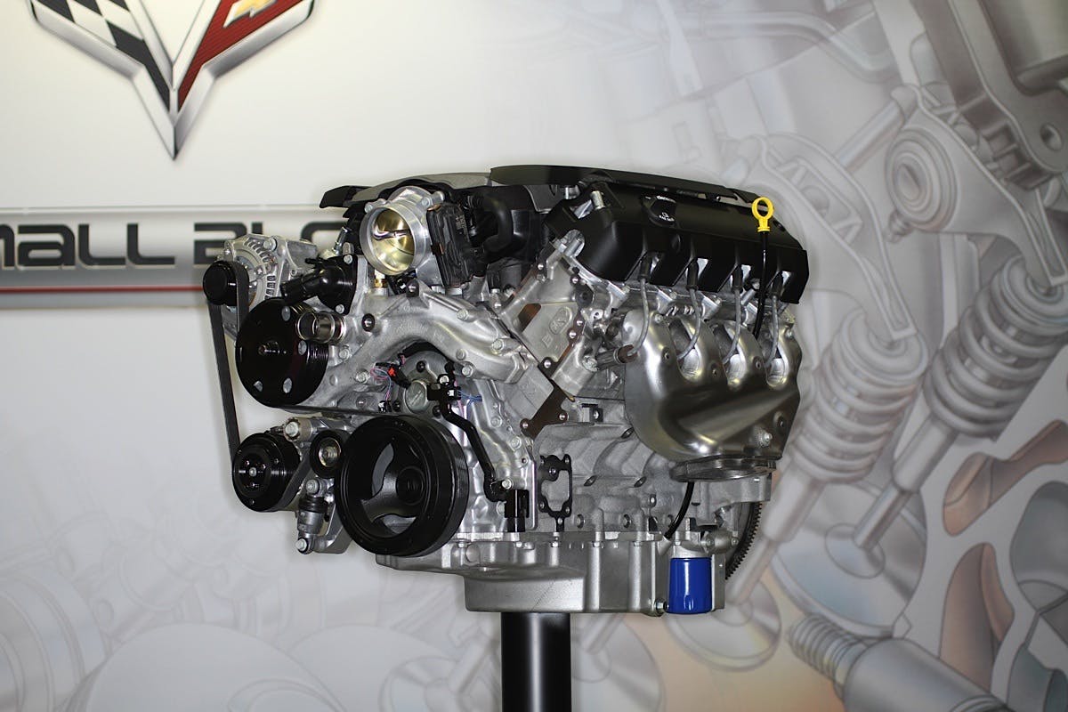

    We will be covering the introduction of the new Gen V Chevy small-block from Detroit. The press conference starts at 8:30 am (EDT) Wednesday, October 24. Check back often during the day to get the latest update on the engine that will power the new Corvette and GM trucks next year.

                          While all of the component parts may be new, the basic design of the engine looks the same to me as the LS series engine which debuted in 1997. So, this is not really a "clean-sheet-of-paper" engine design as was the LS when it first appeared.
                            +1 Joe, I totally agree after looking it over very closely.

                              Although the overall view may be very similar to the current LS-series, the fact that it is a "complete redesign" means there are hundreds, if not thousands, of small changes, and it all adds up.
                              The modest cam duration - only a handful of degrees more than our well known "300 HP cam" combined with an even larger LSA, and even accounting for the more aggressive dynamics afforeded by roller lifters and larger valve circumference indicates that effective overlap is likely in the same ballpark as the 300 HP cam. (Is there a message here?)
                              No indexing information is provided, but the fact that there is a clearance notch in the piston for the exhaust valve, but none for the inlet valve indicates that the range of phasing must be very late, even when the phaser is at full advance.
                              The big block sized inlet valve combined with the small block sized exhaust valve indicates that the E/I flow is likely less than 75 percent, which is why the exhaust lobe has more duration.
                              I'm surprised that displacement stayed at 6.2L, which is good. Most observers expected smaller displacement, which would mean less low end and mid-range torque.
                              Also, notice that it doesn't have roller tip rockers. Gee, I wonder why. Could it be... that they are WORTHLESS?!!!
