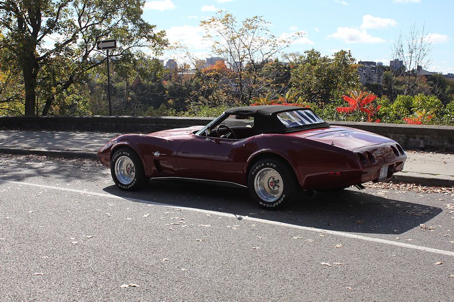

    I am considering refurbishing a hardtop for my 1974 convertible as a winter project. However, the various catalogues show differences between the 68E and 68L-75 versions, particularly in the front mounting latches. The one I am considering "seems" to be 68E (with chrome, not black latches) and I am wondering if it will fit my 1974 without changing out the mounting mechanisms. From the pics provided you will note that it has a center rear mounting stud as well although I suspect that that can simply be removed. I do not have a hole in the center of the rear deck. Any advice on whether this top will fit on my 1974? The condition is perhaps 6-7/10 and it is fairly local so I need not bother with the fuss and expense of shipping.

                        Thanks Joe. No, I don't have the hole in the rear deck. But that is fine; I can remove that center rear bracket/stud easily. As to the seller, we are still quibbling about price. The restoration costs (a black vinyl cover, dye, and some hardware) are close to want he wants for the top. But he doesn't seem to understand that. Or I do not. C'est la vie. I have upped my bid and I have not heard back yet. We shall see if it is time to move on. I have not mentioned $$s here as yet but can do so if anyone is interested.
                        I sure do like that black vinyl hardtop look. RPO C08 in 1974; only 367 units. Looks very nice from the pics I have seen. Whether I will ever use it is another matter. But it would nice to have for my car. I am a bit of a packrat.
