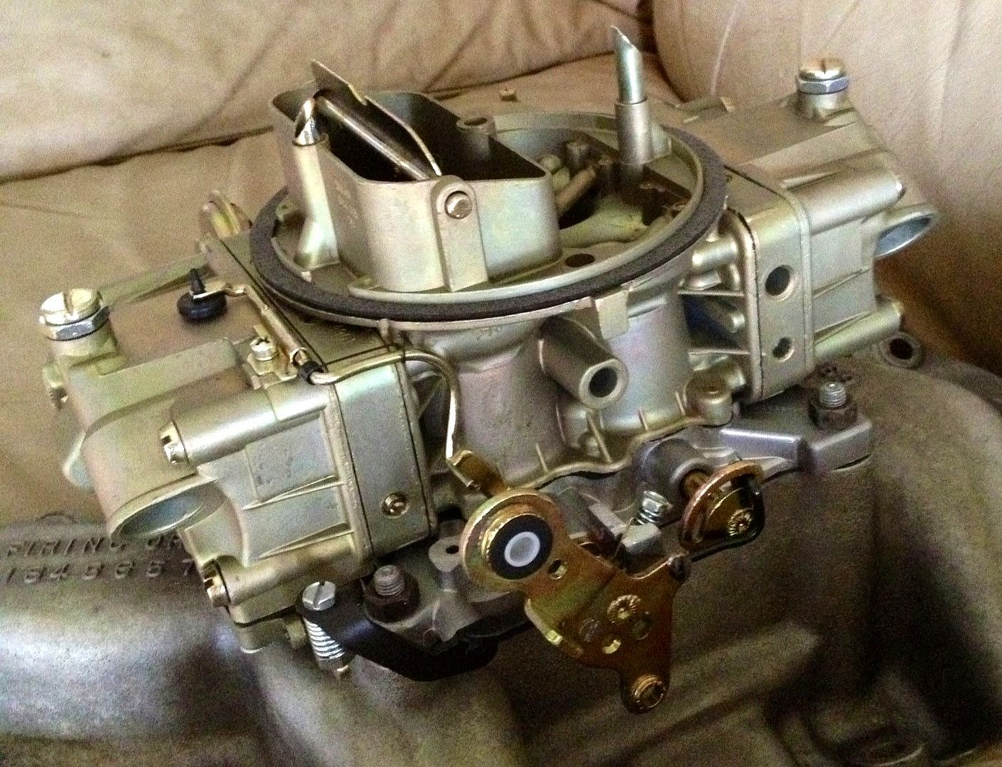

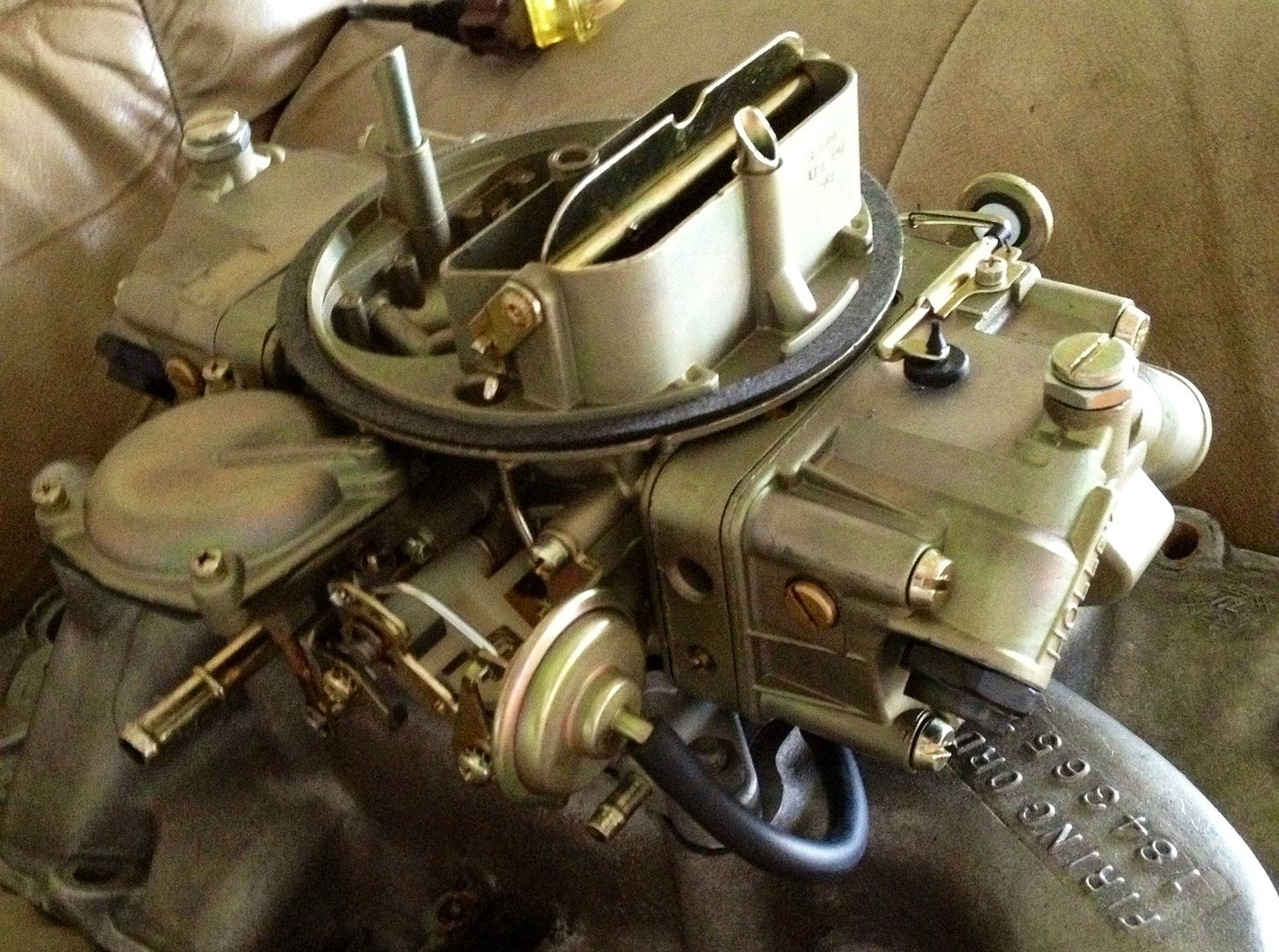

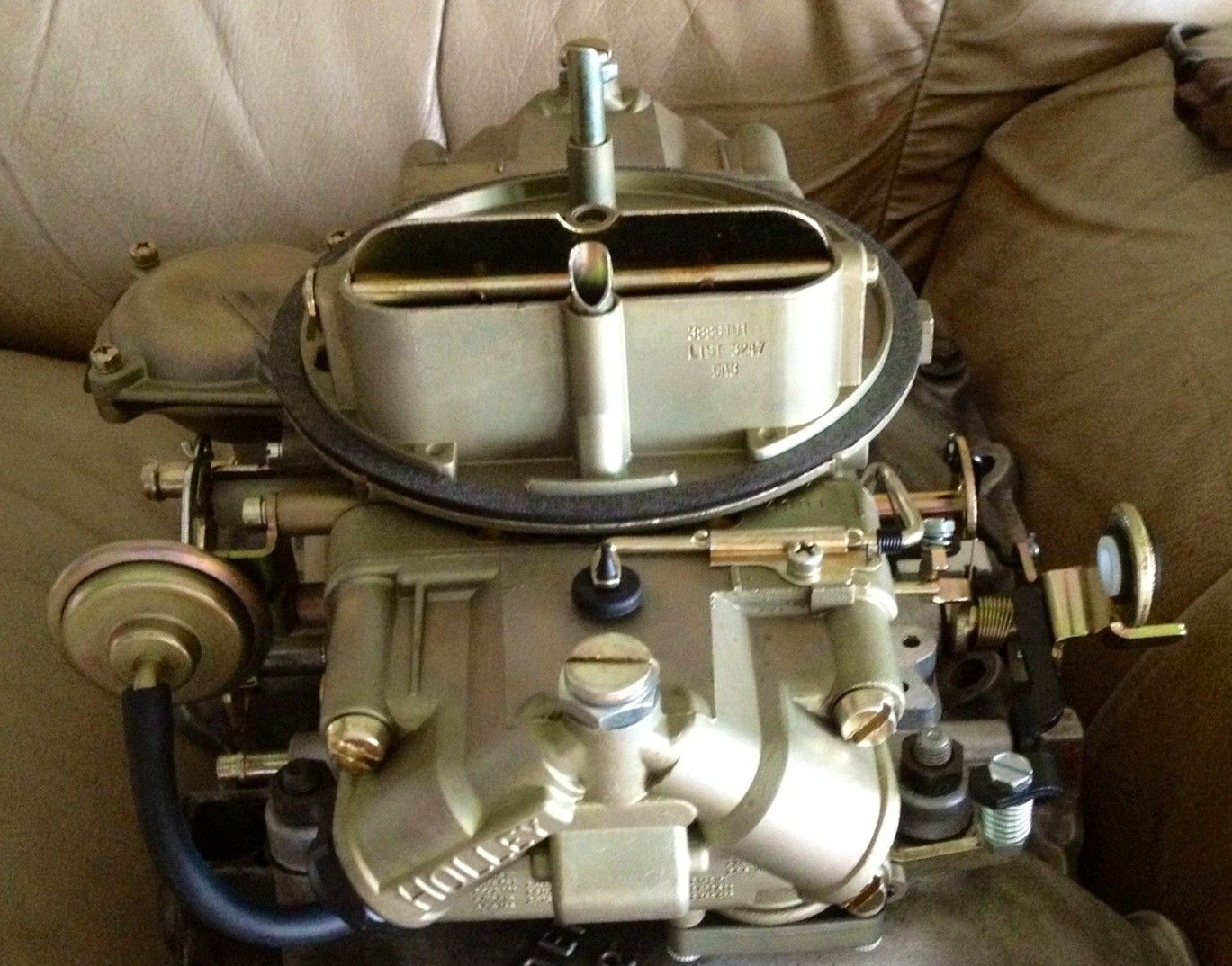

    Just wanted to pass along to the membership about a restorer I have used in the past and just recently used again. His name is Eric Jackson and his company is Vintage Musclecar in Ohio. He restored the Holley on my 69 Camaro and it is still beautiful.
    I am restoring a 66 L72 for a fellow and the original 3247 was old and tired so, I sent it to Eric. From the time I sent it til the time I received it was about a week. Sorry for the iPhone pics. As always, his work is impeccable...

                One fuel inlet fitting was missing and the fast idle cam unloader pin was broken. Both of the metering blocks were warped and they were repaired. The complete R & R including shipping with insurance was $562.80.
                To say this bad boy was a turd when I sent it to Eric, is a gross understatement.
