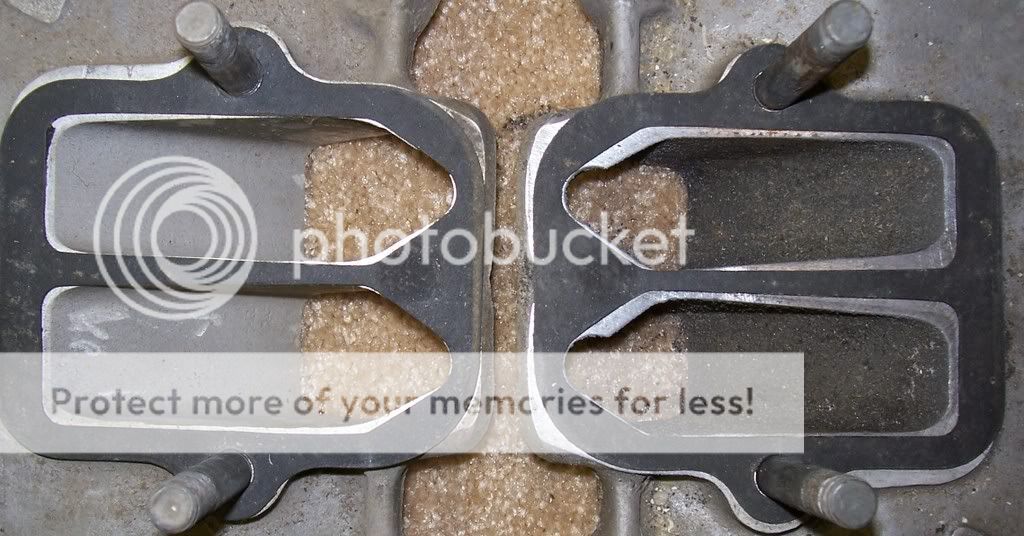

          • Bill M.
            • April 1, 1977
            • 1386
            Re: 1959 290 HP FI Heads
            In order to get maximum benefit from the "big port" heads, the FI manifold runners would have had to be enlarged to match the heads, but I've never been able to confirm by observation if this was done for the '61 big port FI engines.Duke
            "59 bedplate to the right, '61 to the left. Gaskets are identical.
