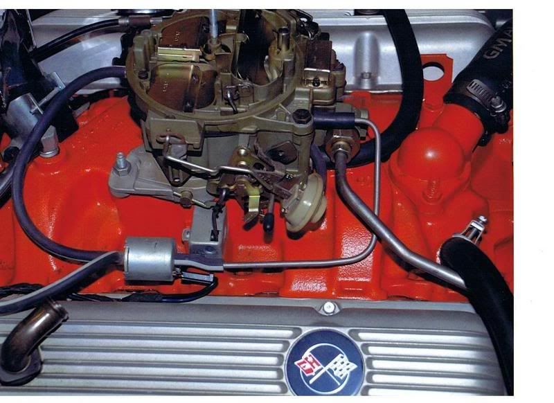

    Can somebody please help me on the placement of the TCS on a 1970?? I have what I believe to be a very original car and it did not have one but it did have the plug for one. I obtained a correct NOS unit from a friend but now I don't know exactly where it mounts to. I did read that some cars did not come with them and have a metal tube setup (which mine has). I've taken a couple of pics for viewing pleasure. Thanks in advance for any and all help.

    How about like this since your photos reveal the most important information -- you have a small block? Different carburetor, but it ought to be close enough. One of the intake manifold fasteners has a stud that the mounting bracket on the TCS solenoid attaches to. Just a nut to hold it to the stud.

        Looks like you are missing the stud that the solenoid attaches too.
          Thanks! Nice looking engine by the way

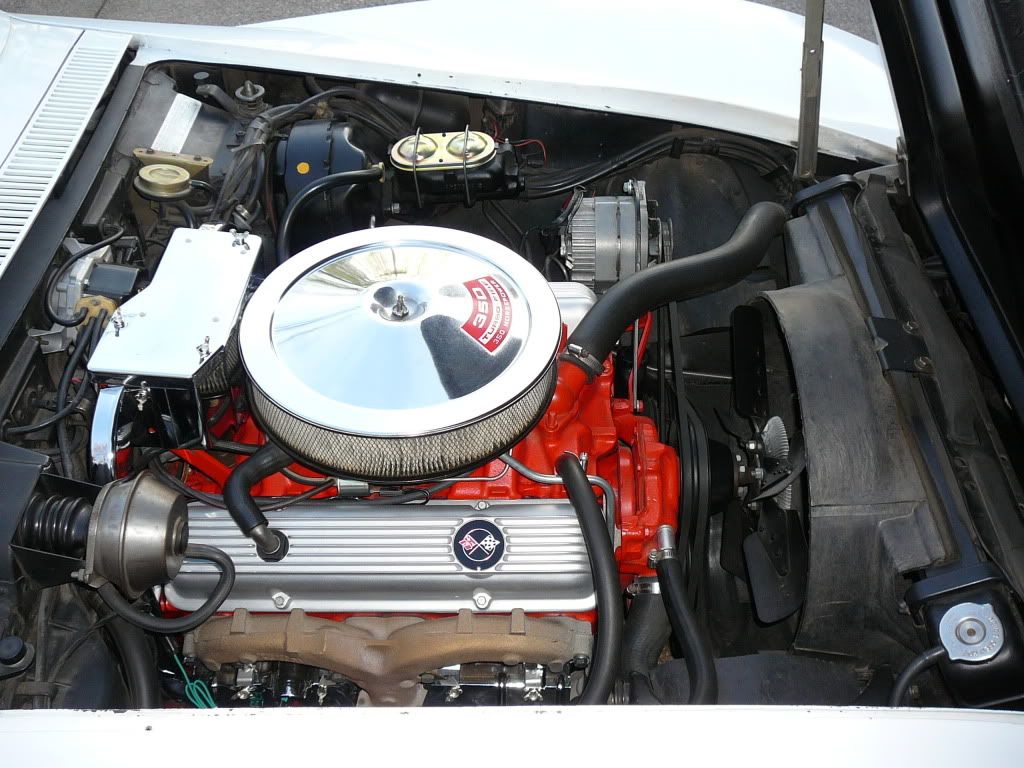

            I was at work and just snagged the pic off the world wide webulator.
            Here's mine,
